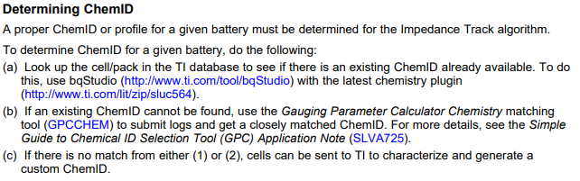

  • Hello wyatt,
    As per the TRM note
    Here i have found 3000mAh battery and in our case also 3000mAh lifePo4
    Can i use the same one ?
    Please advise
    vishal kalmani

  • Hi Wyatt,
    Thanks for the alternate part but it is not P2P.
    Ok here i am attaching  images
    As per the TRM note
    I will carry out learning cycle as per your suggestion
    Please advise
    vishal kalmani
  • Hello Vishal,
    I would suggest running a log cycle of the batteries with the full range and using the GPCCHEM tool instead of picking one with similar characteristics, those two characteristics of a battery could still have much different chemID information. If this is the same exact battery (us26650ft) then it should work, but otherwise I could not say if it will.
    You can test it if you'd like, but there are too many unknowns for me to give much information on the accuracy of the gauge with this application.

  • Hello Vishal,
    Let me summarize to have a full picture:
    1. If you have the exact battery that matches the chemID (the identification number), you don't need to log a cycle and submit to the GPCCHEM tool
    2. If you don't have the exact battery then you will need to log the full cycle of the battery according to the battery specifications, then use the GPCCHEM tool to find the chemID.
    3. After the chemID is uploaded, you can do the learning cycle which must have a 90% DOD change, otherwise it won't be successful, the 90% is based on your design capacity.
    Sincerely,

  • Hello Vishal,
    If you are in the flat region of the OCV the VOK wont set when expected because the gauge will not take an OCV reading for Qmax in this region. Also make sure you discharge 90% of the design capacity for the successful learning cycle.
    The Achieving a successful learning cycle is written for many different gauges, you can use it as a guide but for the gauge specifics you have to refer to the TRM.
    Can you share your chemID report you received from the GPCCHEM tool?
    Sincerely,
    Wyatt Keller
  • Hello Wyatt,
    As per discussion with TI guy shashank  we have set fast qmax end dod  is 51%.
    The chemid we are flashing is 0466 .
    I had compared Ra table using .gg file some of the value got changed even though qmaxupdate is not set . Can we generate and enter 06 update status manually and start testing ?
    Thanks ,
    Vishal
  • Hello Vishal,
    No, you want to at least update the Qmax.
    It seems like the chemID is not a good match for the battery cell. Are you able to choose a different one from the GPCCHEM match?
    Make sure it is within 5% DOD error.
