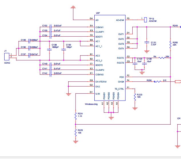

We have previously used BQ51003 supporting 500mA,but the IC didnt support 500mA  in our board.So we bought BQ51013B with 1A .We did the below cases and found issues,
1.Tested for 200mA :
   RILIM=1.1 K Ohm,worked as expected.
 2.Tested for 500mA
  RILIM=300 Ohm,but device was not continuosly charging and it stopped after few mins.
3.Tested for 800mA
 RILIM=130 Ohm,device was not charging.
We want the IC to support all the above cases and we need the solution to solve this issue.
