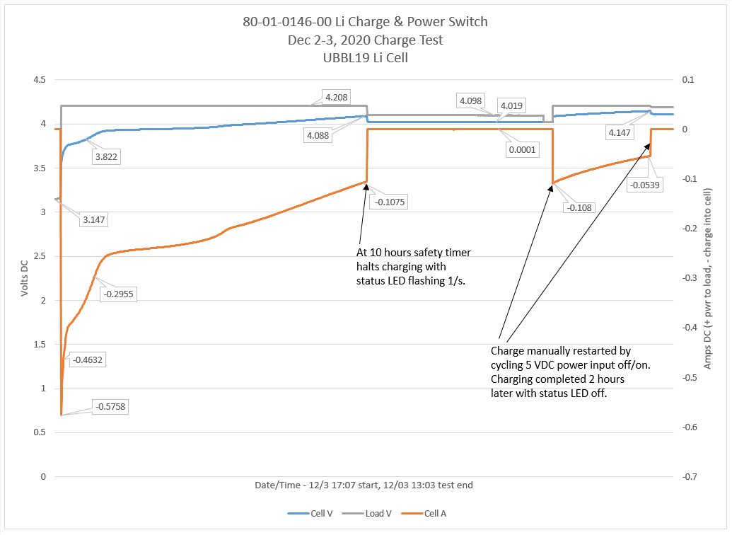

  • Back in the office today I have setup a longer period charge test of the BQ25616 based circuit. Using the smaller test cell (UBBL19 2.4Ah from UltraLife) I pulled 1Ah of charge out of the cell into a test load. The cell was then connected to the BQ25616 circuit which is also connected to a logging meter that will record voltages and current as the test runs overnight. After 3 1/2 hours the battery node is at 3.91 VDC with 270 mA of charge current and the load node (SW) is at 4.21 VDC. It will be interesting to see the results tomorrow morning. One hopes in another 6-7 hours cell voltage reaches Regulation level 4.2v and current the Top Off rate.
  • Here are the results of a 19 hour charge test of the BQ25616 circuit in development charging an UltraLife UBBL19 2.4Ah cell.
    For data logging a Graphtec 200A logger was used to record the cell and load voltages and current into or out of cell across a 1 ohm sense resistor. The sense resistor is in series between cell positive terminal and BQ25616’s BAT node.
    In the following data graph top grey trace is load voltage, middle blue trace is battery voltage, and bottom orange trace is battery current. Data was recorded for 19 hours starting afternoon until following morning. With data recording started the 5 volt charge voltage was left off for 5 minutes, this is seen on the far left of the graph battery and load voltages ~3.6v and 0.9 mA into test load. Once 5 volt charge voltage was applied load voltage went to 4.2v, battery voltage 3.8v and charge current -277mA. The ICHG set resistor has been changed from 274 to 3.4k ohms therefore initial charge rate is within 2mA of calculated value. Over next 10 hours cell voltage rose as charge current decreased. At 12:40AM when cell voltage reached 4.139v and charge current at -61mA charging ceased. Over next 9 hours load voltage stabilized at 4.18v, cell voltage 4.11v while 0.3mA exited cell into load.
    Upon returning to the bench in the morning the BQ25616 circuit’s STATUS LED was flashing rather than off. Attached oscilloscope capture shows load and cell voltages stable with the ‘scope reading a bit higher than 200A logger. The STATUS LED was cycling at 1 Hz indicating charge suspend fault.
    I am pleased with the voltage and current curves recorded. Disappointed circuit entered error state rather than top off timer.
    Hong Mao (or others) I would appreciate your thoughts as to why with the cell at its charged voltage the BQ25616 declared a charge suspend fault rather than entering top off mode.
    Thank you very much for your update!
    Ning.
  • You are welcome Ning. Issue is not resolved, need to determine why BQ25616 is not going into STATUS LED off top up mode at end of charge cycle.

  • Two questions arise from this test:
    1. Why did the BQ25616 error at 58 minutes halting charging early?
    2. Why in this and previous testing is the charge rate set by the ICHG resistor never achieved?

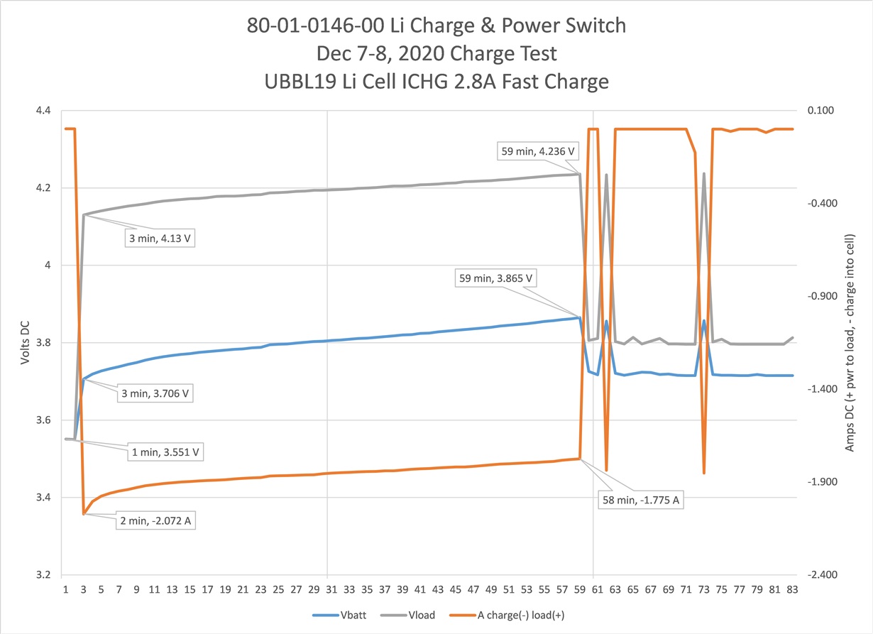

    Results of a 15+ hour charge test of the BQ25616 circuit in development charging an SAFT MP176065 5.6 Ah cell.
    For data logging a Graphtec 200A logger was used to record the cell and load voltages and current into or out of cell across a 0.1 ohm sense resistor. The sense resistor is in series between cell positive terminal and BQ25616’s BAT node. Previous 1 ohm sense R changed to 0.1 ohm testing if the 1 ohm in series with cell was effecting test.
    With 10 hour charge safety timer continuing to expire before cell is charged this test setup for a fast charge configuration. The charge rate was increased to 2800 mA. ICHG resistor = 243 ohms. Input current limit ILIM resistor changed to 150 ohms setting input current limit to 3200 mA. The plan was with 2800 mA available for 10 hours cell should have time to fully charge before safetytimer expires.
    In the following data graph top grey trace is load voltage, middle blue trace is battery voltage, and bottom orange trace is battery current. Data was recorded for 17+ hours, only the first 83 minutes is graphed as remaining behavior is similar to that shown after one hour.
    Programmed maximum charge current is never observed during test. Initial logging recorder samples are with charge power off documenting test cell voltage at 3.55 volts. When charge power is applied 2 amps of charge current are observed at the cell and on bench supplies amp meter. After 58 minutes with charge current at 1.78 A and cell voltage 3.87 V charging terminates. The STATUS LED is flashing and the behavior seen on the graph with occasional charge retries attempted then shut off goes on for next ~16 hours until test is stopped following morning.
    This run demonstrates circuit is capable of charging at rates between 1.75 to 2 A. In theory rates sufficient to charge the target 5.4 Ah cell well before the 10 hour safety timer expires. However the test failed because the BQ25616 declared an error halting charging after ~2 Ah.

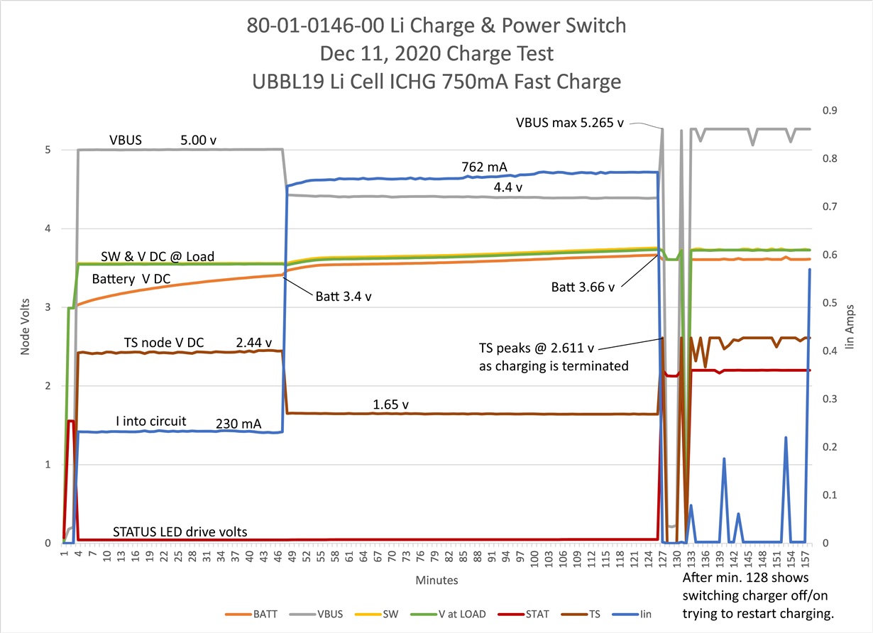

  • Hello Ricardo and fellow toilers in the fields of electrons storage via chemical means.
    Thanks for your input on current measurements and the theory OVP halted the previous test out of fast charge mode. We do have a couple of DMM with max value function I will use during this weekend’s testing on SYS and VBUS.
    Presently my biggest issue remains understanding factors effecting charging current. Tests run Dec 8-9 and Dec 9-10 set the BQ25616 near its highest specified charge rates. For the 8-9 test ICHG @ 1.99A (R=340ohms) then 9-10th test ICHG @ 2.78A (R=243 ohms). In both cases ILIM 3.18A (R=150 ohms). In both ~16 hour tests charge currents of ~230-240 mA were raised as the cell voltage varied 3.6 to 3.7 VDC for the first 3.2 to 3.4 VDC on the second night. After 1 – 2 hours STATUS goes from ON to flashing and charging essentially stops.
    For today’s bench experiments I used both cells and the TI App note battery simulator. With the ILIM=150 ohms and ICHG =243 ohms it was confirmed it would charge the SAFT 176065 cell at ~230 mA. Duplicated previous night’s test rate. Replacing the cell with the power op-amp battery simulator sink that configuration raised 400 mA of charge current. Suspecting setting the ILIM and ICHG so ‘wide open’ as a cause ICHG was changed to 1.02A (R=665 ohms). No change to ILIM. With ILIM at 3.18A and ICHG at 1A the circuit raised 750 mA into the battery simulator. Replacing the battery simulator with a discharged cell I observed:
    231 mA charge current battery voltage 3.09v
    233 mA charge current battery voltage 3.33v
    753 mA charge current battery voltage 3.52v
    Reading from the data logger’s small screen the transition to 750 mA charge occurred ~15 minutes into the test. As I type this 70 minutes into the test still charging at 750 mA.
    Comments? It appears backing ICHG down to 1A helps but I continue to puzzle that calculations yield 1A charge current and on the bench 750 mA is seen. Is the BQ25616 reacting to the impedance of the cell (or battery simulator) and loop Z of PCB and connecting wires? Revisit SW output inductor or protection MOSFET on VBUS? The plan is to let this test run and see if the circuit attains a flat constant current charge through the Fast Charge phase then taper I off at Voltage Regulation.

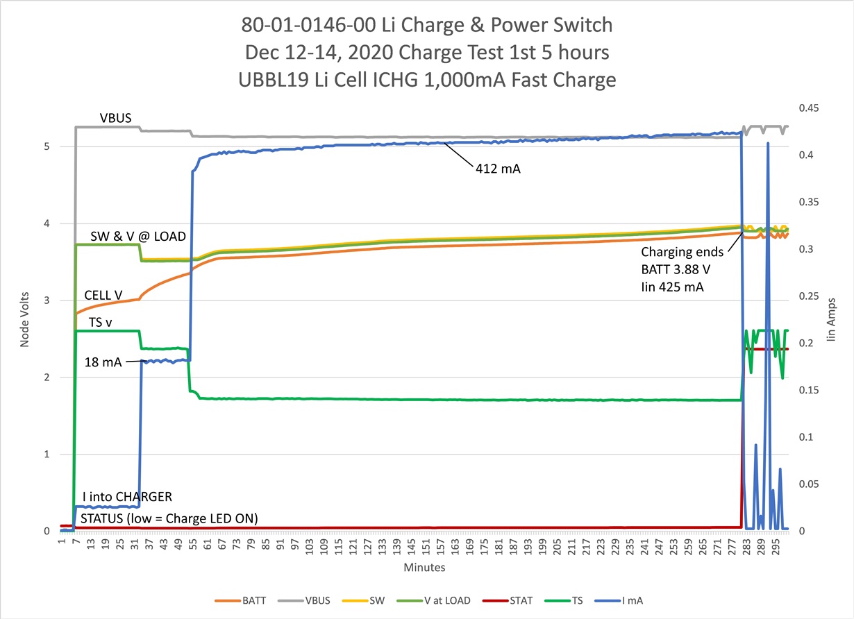

  • Results of a 2 hour charge test of the BQ25616 circuit in development charging an SAFT MP176065 5.6 Ah cell.
    For data logging a Graphtec 200A logger was used to record the cell and load voltages and current into or out of cell across a 1 ohm sense resistor. The sense resistor is in series between bench supply and circuit input.
    Suspecting setting the ILIM and ICHG to ‘wide open’ maximum setting as an issue in previous fails ICHG was changed to 1.02A (R=665 ohms). No change to ILIM (R=150 ohms). With ILIM at 3.18A and ICHG at 1A the circuit raised 750 mA into the battery simulator.
    In the following data graph additional nodes are being recorded as labeled on graph.
    Programmed maximum charge current is never observed during test. Initial logging recorder samples are with charge power off documenting test cell voltage at ~3 volts. When charge power is applied 230 mA of charge current are observed until after 45 minutes when battery voltage reaches 3.4 volts charge current increased to 750 mA. Charge current is held stable between 750 to 765 mA until just after 2 hours into test with battery voltage at 3.66 volts charging is terminated and STATUS goes high. As charging terminated a peak at 2.611 volts was recorded on node TS. Attempts to restart charging by cycling power on VBUS were unsuccessful. Even turning off charge power and disconnecting battery to force IC reset resulting in error flashing STATUS LED when battery was reconnected and charge power reapplied.
    Noting drop on VBUS to 4.4 vdc due to current shunt the next test will replace 1 ohn current shunt with 0.11 ohm and also implement capture of overvoltage events on VBUS and SYS nodes using Fluke 289 meters.
  • Norman,
    It definitely looks like you are in VINDPM during fast charge and that is the reason you are not seeing your full charge current. This is most likely due to your large sense resistor.

    And here is a test run over last weekend. Charged for 5 hours loading 1.6 Ah into the cell before terminating at cell voltage of 3.88v. VBUS and SYS were monitored with Fluke 289s in min/avg/max mode showing maximum VBUS = 5.261v and maximum SYS 4.275v.
  • Today’s investigations looked into the battery voltage levels at which the BQ25616 changes charge current delivered to the cell. With VBAT power at 5.25 VDC and the current limit remaining ICHG 1.02A (R=665 ohms) and ILIM 3.2A (R=150 ohms) the SAFT cell was replaced with the Battery Simulator detailed in TI Application Report SLVA618 and all current shunt resistor or current meters removed from the circuit. The current listed below were read from the +-12 VDC bench supply powering the battery simulator, as it sinks the charge current it shows on the -12 volt rail’s current meter with 2-digit resolution. For the test two different prototype PCBAs of the circuit were presented with voltages at their BAT between 2.0 V (min volts before cell’s protection circuit disconnects it) to 4.25 V (cell fully charged). Voltage increased in 0.25 volt increments with an extra data point at 3.8 volts as this was an obvious transition point.
