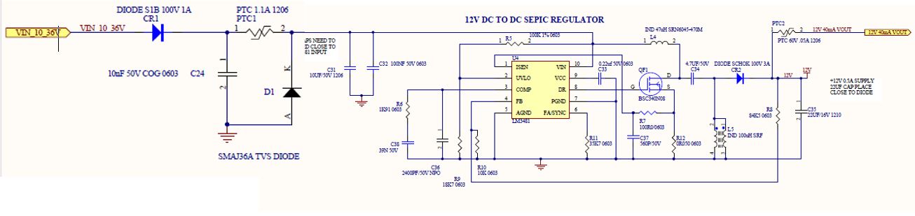

Below is the design of converter. Please let me know if there is any solution to eliminate noise form  SEPIC converter.
  • Hi Yagita,
    Thank you for designing with the LM3481.  It is not very clear whether or not your L4 is connected to the input line. There is missing a junction do. Could you double check, and make sure the schematic is up to date?

    Yes you are right, the design was not complete. The converter has 10-36VDC input. Below is the complete snap of it.

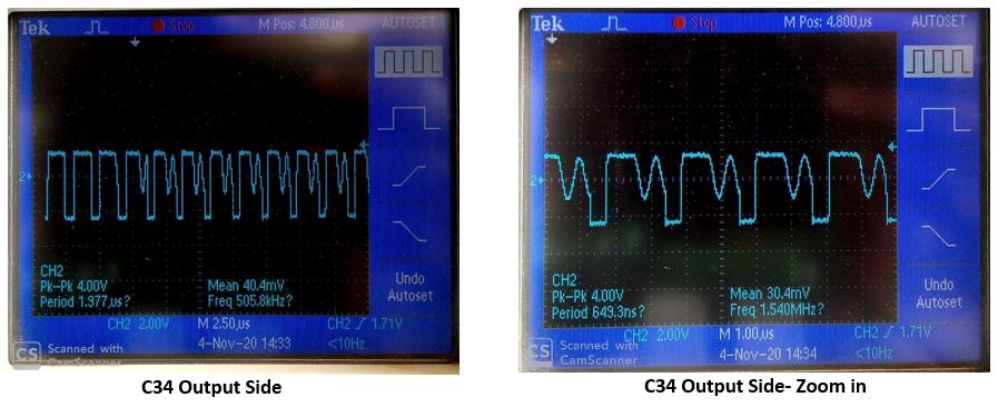

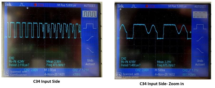

    I had captured signal waveforms at 24V (0.133Amp) at both the sides of C34 to GND. Below are the zoom in and zoom out pictures of it. Please have a look  and let me know your thoughts on this.
    Yogita
  • Hi Yogita,
    Thanks for sharing the images. Can you explain what is happening in the C34 Input and Output side photos when the switch node changes shape? Are you doing a load transient there?

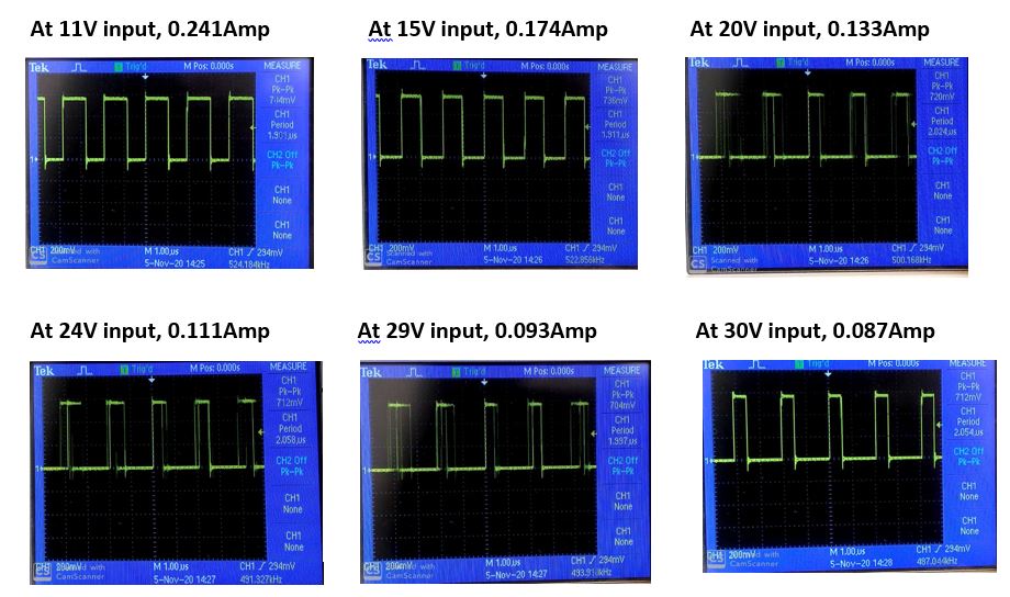

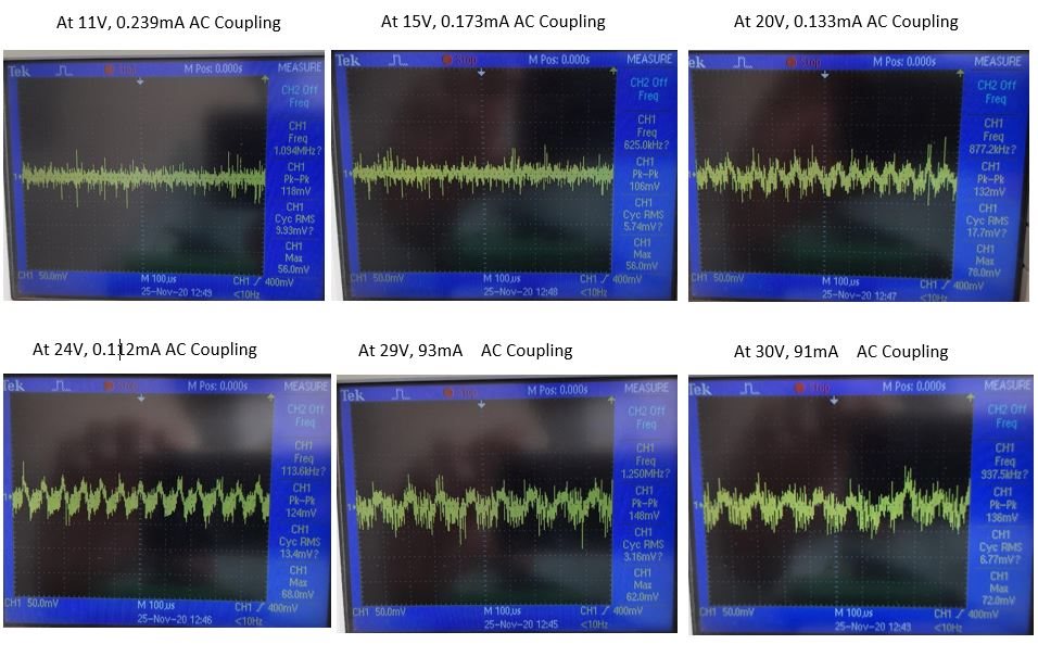

    I had observed gate pulse on DSO, and the signal shows jitter in duty cycle in the range of 20-29V(0.133-0.086Amp) input supply. Please have a look on below snaps taken at different input voltages. The SEPIC converter operates at 10-36V input supply voltage, 12Volt output.
    I am looking forward for your response.
    Yogita
  • Hi Yogita,
    Thank you for providing the waveforms in addition to the ones provided above. From this, it looks like there may be an issue with the loop stability of the SEPIC converter. One giveaway of that is in your second post on the C34 input side photo. It looks like the part is switching normally, and then the switch node showcases a little glitch before showcasing the sinusoidal behavior.
    Can you take a scope shot of the COMP pin during these conditions, and see if the COMP pin is oscillating?

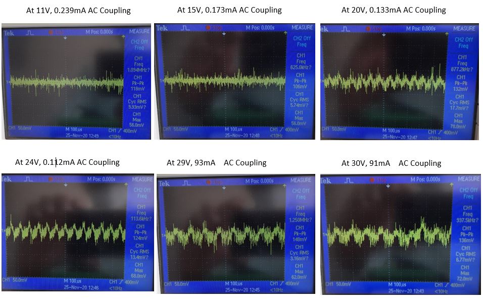

    Sorry for the delay in getting back to you. Please find below snaps from DSO at COMP pin,
    Yogita
  • Hello Yogita,
    The COMP seems to oscillate with a frequency around 10kHz which might cause audible noise.
    Please send measurements of your output voltage, input voltage, and both sides of the coupling capacitor if possible in one scope plot.
    Did you follow the calculation of the compensation in this app note?
    If yes, please let's make the compensation very slow to stabilize the converter and then check what we need to do to fulfill the system requirements needed on the compensation.

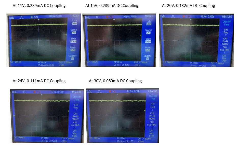

    Thank you for your response. Please find below image which shows waveform for input voltage, output voltage, input side of coupling capacitor(C34) and output side of coupling capacitor.
    • Yellow : Input Voltage measure across C32 and GND i.e. 24V
    • Cyan   : Output Voltage measure across C35 and GND i.e. 12V
    • Pink    : Waveform across Input side of coupling capacitor C34 and GND
    • Green : Waveform across Output side of coupling capacitor C34 and GND
