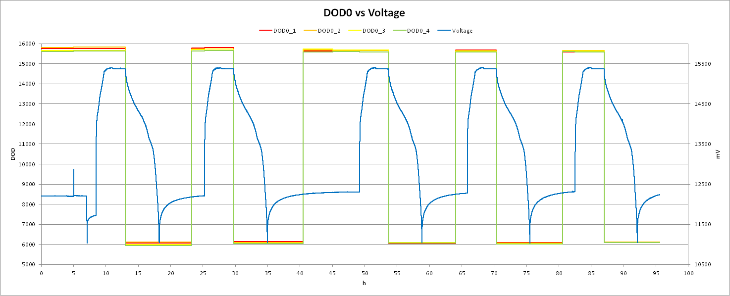

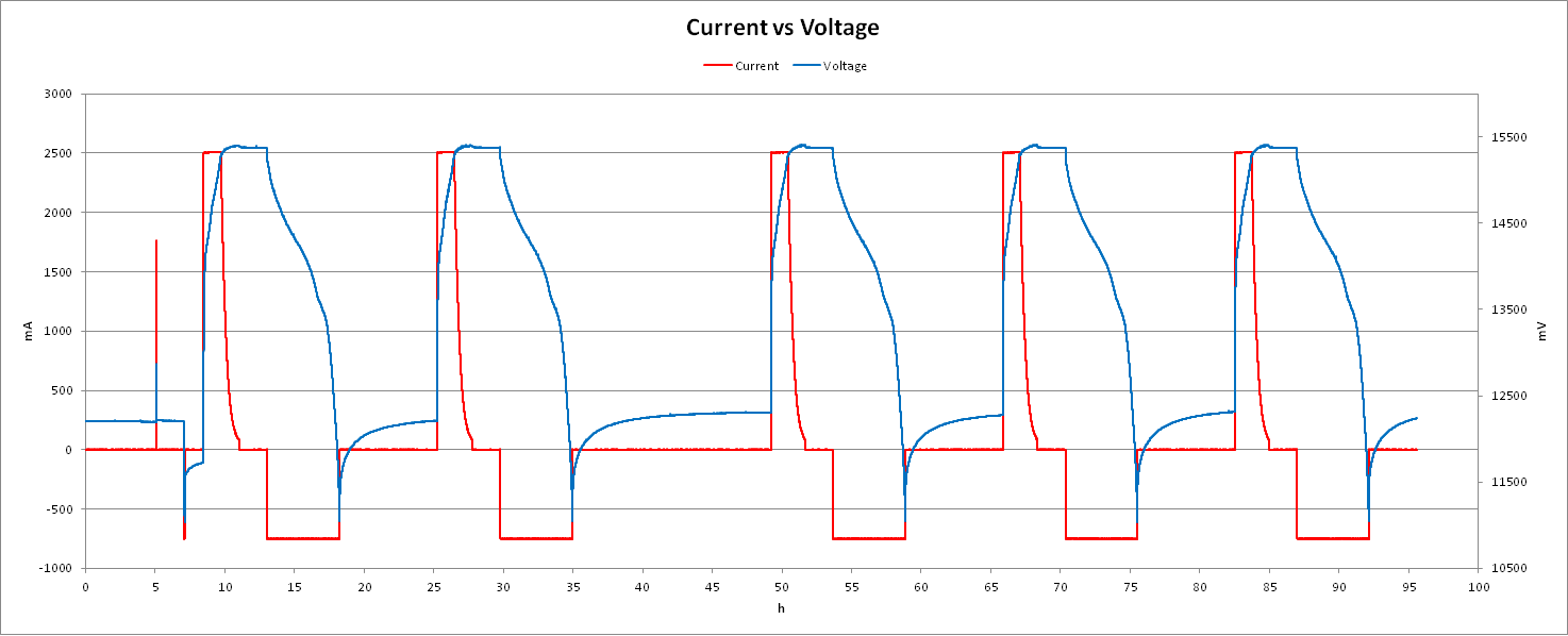

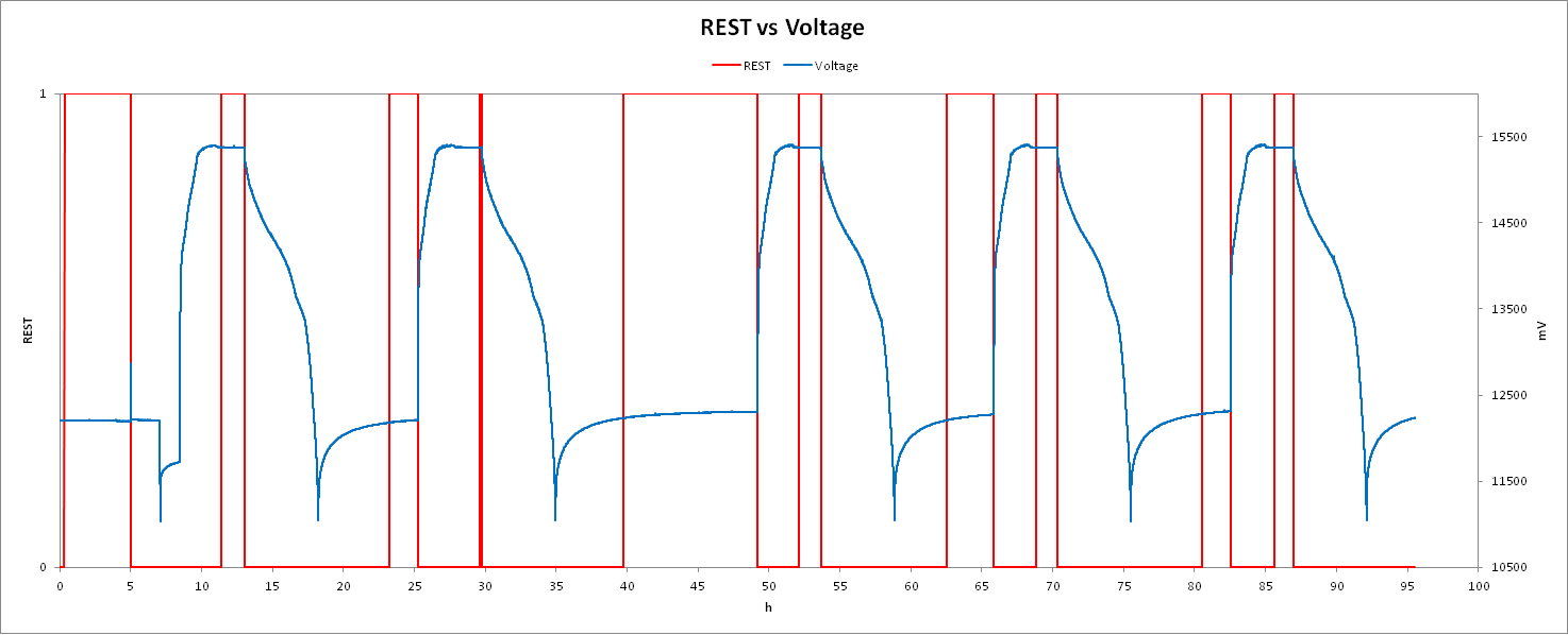

    Below is how I did my learning cycles:
    1. Program the chem id 1762.
    2. Enable fuel gauge then full reset.
    3. Discharge to 11V using 1.3A.
    4. Rest 5 hours.
    5. Charge to 16.8V using 3.35A down to 80mA.
    6. Rest 2 hours.
    7. Discharge to 11V using 1.3A.
    8. Rest 5 hours.
    9. Charge to 16.8V using 3.35A down to 80mA.
    10. Rest 2 hours.
    11. Discharge to 11V using 1.3A.
    12. Rest 5 hours.
    Update status changed from 0x04 to 0x05 automatically during step 6.
    Please advise if the whole process was correct.
    Zhihan

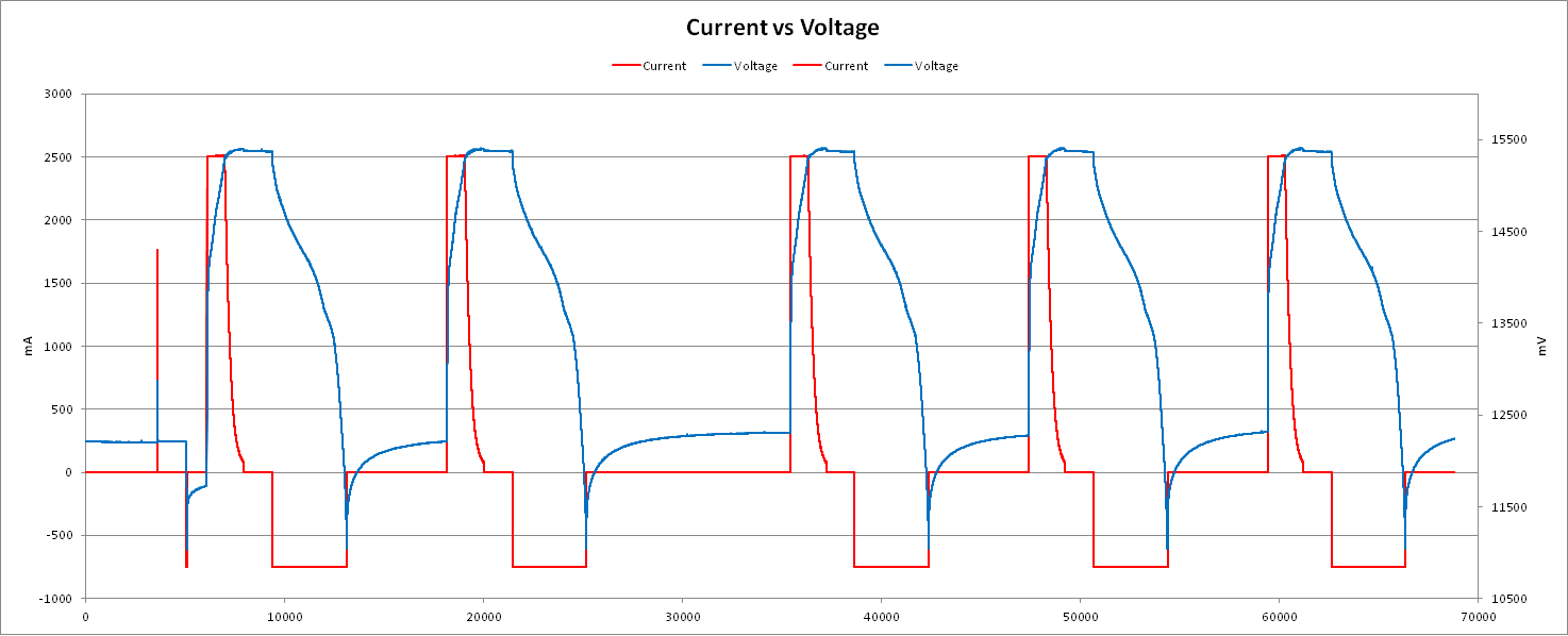

    Thanks for the reminder! I almost forgot. Please kindly review attached zip file. Log data and some exported GG files during the learning cycle are all included.
    Zhihan
    S617 Chem ID2155.zip

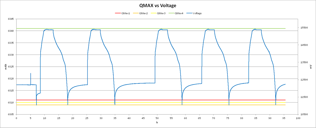

  • Hello Zhihan,
    I see in the log the discharge current is more than C/5 (C = design capacity, max discharge for learning cycle for your battery is 780mA) I would consider setting it at 700mA.
    The information regarding the required currents with thresholds programmed to the gauge are outlined in SLUA903.
    Your cycles look good, you were able to get a Qmax which shows you cycled the batteries 90% DOD, but the current must be within C/5 and C/10 for Ra updates during the learning cycle.

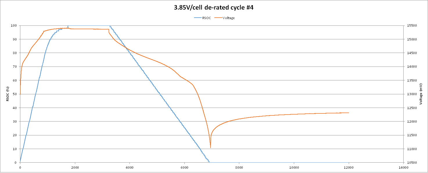

    Thanks for the update! However, I'm getting more and more confused.
    So we are having at 4S2P battery application that requires only 3.85V/cell de-rated charging and operation voltage from 2.8V/cell ~ 3.85V/cell. The lithium ion cell we use according to its datasheet has standard operation voltage from 2.5V ~ 4.2V. Based on our measurement, battery capacity under 2.8V ~ 3.85V/cell is about 3900mAh and nominal will be 6500mAh (min) per cell datasheet. Charge Term Taper Current we will just use cell datasheet condition.
    Per your suggest for learning cycle, we should set cycle condition for learning cycle based on cell datasheet not application. Plus, design capacity is set to nominal capacity from datasheet. So with 6500mAh for design capacity, when we actually apply de-rated application, FCC will significantly lower than design capacity that results in significantly low SOH, ~60%, which I don't think that will make sense since we are just using very little portion of the cell not that the cell is already very aged.
    Plus I assume I should set Term Voltage to 10V not 11.2V?
    Also you mentioned VCT and FC. Current GG uses default FC set condition which is VCT. And VCT is affected by ChargingVoltage(). ChargingVoltage() is reflected under Advanced Charge Algorithm for T1~T2, T2~T5, T5~T6, T6~T3, T3~T4. So what voltage should we set for ChargingVoltage(), 4.2V or 3.85V?
    If we set everything in GG based on cell datasheet, how is this GG helpful to our real application even if learning cycle is successful? Because I assume learning cycle is for IC to learn real application by cycling use real situation and GG is customized for real application as well. Please kindly advise.
    Also can you please kindly review GG again and advise all the parameters needs to be adjusted for my case? I don't prefer to repeat cycles again and again with one or two parameters adjusted every time.

  • Hi Nick Brylski,

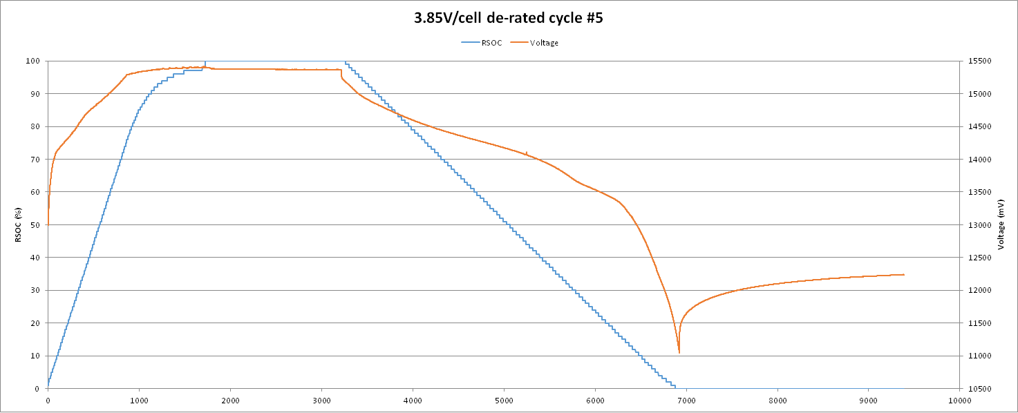

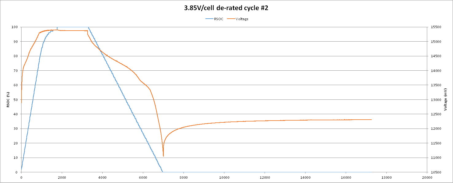

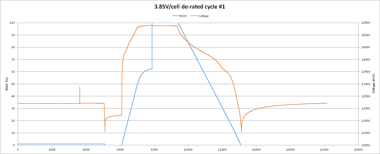

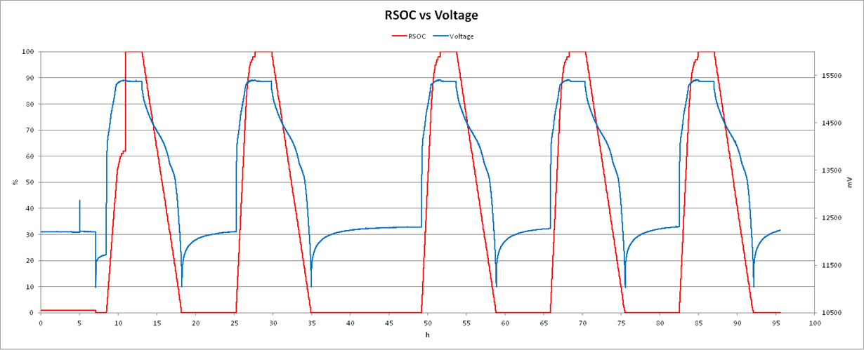

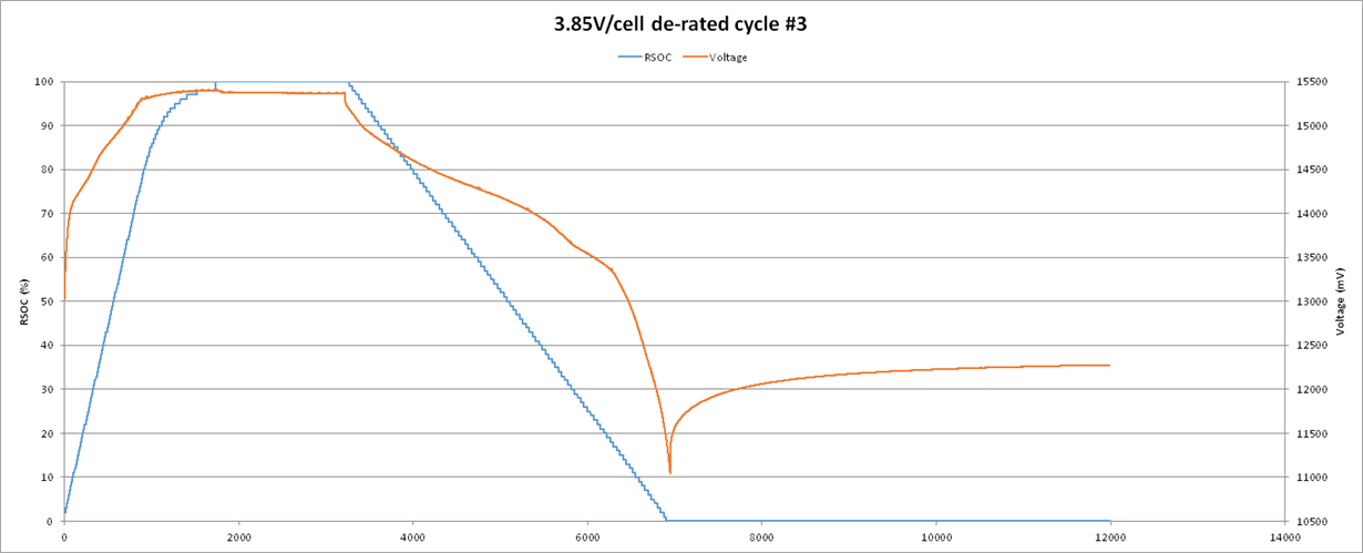

    We have re-run the learning cycle based on cell manufacturer specification (voltage range, 0.2C discharge, design capacity and term voltage). The learning cycle looks good. Then we changed design capacity and term voltage to application specification, and have run additional 6 cycles based on application specification. Most registers looks good expect CELL1,2,3,4 QMAX. The QMAX of the cells were not updated. Can you please  kindly advise what adjustment would be needed?
    I'd like to upload my data but the file sizes are way too large. Is there any other way to share those data to you?
    Zhihan
  • Hello Zhihan,

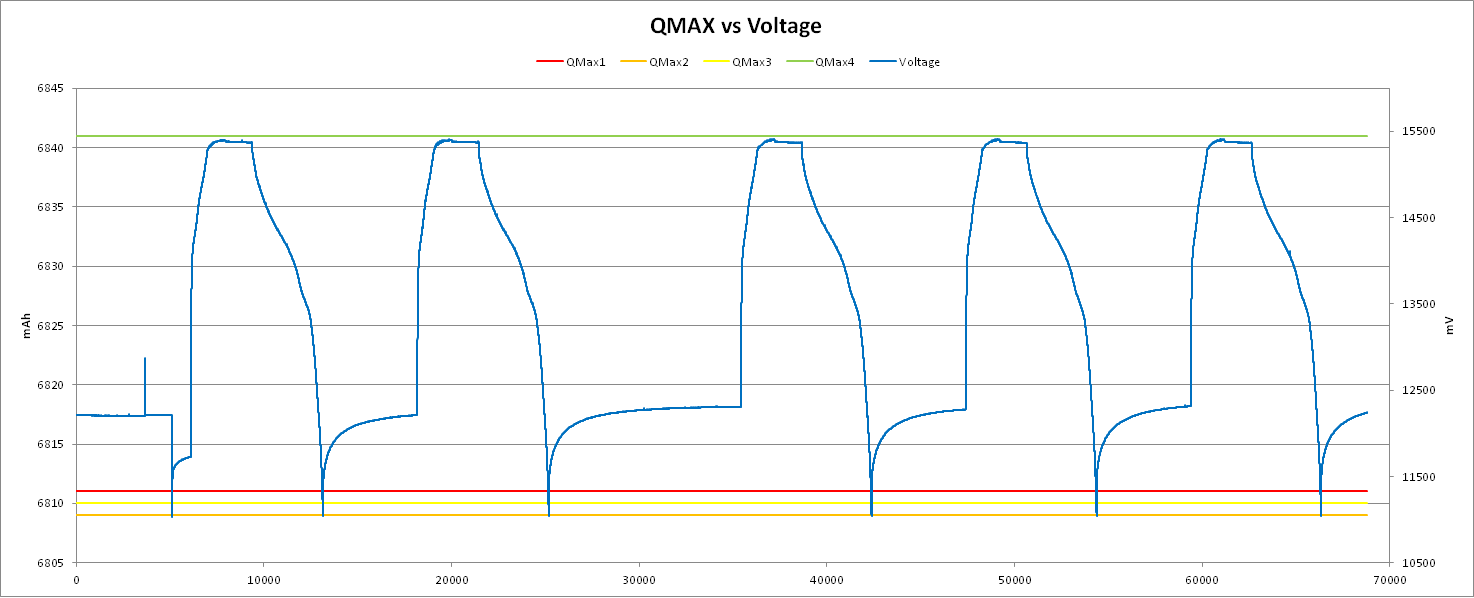

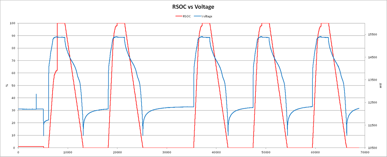

    Are you having an issue with SOC jumping? Qmax will be updated as the batteries age and conditions change.
    If there are not issues with gauging the Qmax values should be ok.
    Sincerely,
    Wyatt Keller

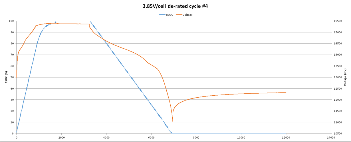

  • Hi Wyatt Keller,
    For QMAX, based on the observation on my other applications, it will change more or less after each chg or dsg cycle. However in this case, it doesn't change even 1mAh, so I'm not sure if this would be an issue for aging expectation.
    For SOC jump, It looks like, more or less, during charging, SOC jumps near ~98%. Except in 1st cycle, it jumps from 60% to 100%. In the rest 4 cycles, SOC jumps from 98% to 100%. Please see below figures as summary. Also attached gg files (before learning, after learning done, and adjusted for 3.85V cycles which is after learning is done). Please kindly review and advise.
    Zhihan
    Before learning.gg.csv
    learning complete.gg.csv
    Adjusted for 3.85V cycle.gg.csv
  • It looks like the figures were not uploaded correctly. So upload again. Please kindly review.
  • Hello Zhihan,

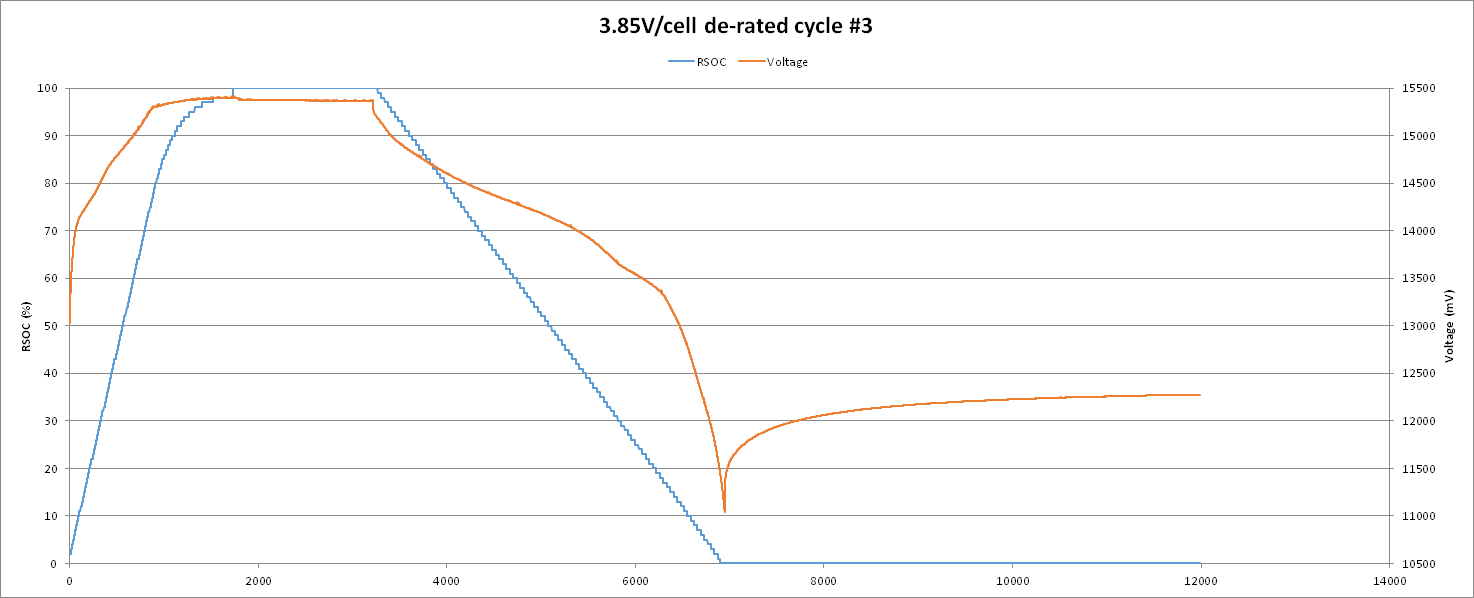

    The later cycles look good, a small jump of 2% near EOC (end of charge) would not be very worrisome.
    You can check if Qmax is being updated by enabling lifetime data and checking after you cycling the batteries by at least 37% and include the relaxes.
    Sincerely,
    Wyatt Keller
  • Hi Wyatt Keller,
    I checked the data log, MfgStat = 0x1F8 all over the time. So I believe lifetime is enabled during all 5 cycles. Below figure is comparing QMAX to Voltage. Not sure if this is reflecting the QMAX lifetime you mentioned. It looks that QMAX is just flat, no any changes.
    Also attach Current vs Voltage and RSOC vs Voltage as references to show the state of the battery.
    Please kindly review and advise any other data you'd like to review. Do you think we should run another e.g. 5 or 10 cycles to verify if QMAX will be updated?
    Zhihan
  • Hello Zhihan,
    Do you have IT enabled for all the tests? If the learning cycle was completed before the start of the logs you showed then the RSOC should be tracking.
    Qmax will not update if the rest between cycles is not long enough (which is what it looks like from the graphs) There needs to be 5hr rest or check the bits to see if an OCV was taken.
    If no OCV was taken the Qmax won't update.
    Sincerely,
    Wyatt Keller
  • Hi Wyatt Keller,
    Yes,  IT is enabled for learning cycles and application cycles. (ITEN bit of LStatus was set all the time.)
    Sorry for misleading. I didn't adjust x-axis because there seems some max limit for ElapsedTime from log data. Log interval was 5s. Below are the correct ones. When we did the cycle, we set 2 hour rest after charge and 5 hour after discharge. So I think the rest time probably is not the problem.
    BTW, is there any way to increase ElapsedTime limit in the log data? I found in my data, max value is nearly 60000s then it will start over from 0s.

  • Hello Zhihan,
    Were the DOD values changing as well? Were there OCV's being taken? If the OCV measurements are being taken Qmax will not update. You can check in the bit registers if an OCV was taken and if it qualified for Qmax update.
    Sincerely,
    Wyatt Keller
  • Hi Wyatt Keller,
    It looks to me, DOD were changing. But I'm not quite sure how to interpret these values. Can you please a little bit? Also please kindly review below figure showing DOD0 values.
    I also checked IT Status, REST bit was set during rest period. Please see below figures showing REST bit status.
    Zhihan
  • Hello Zhihan,
    Can you share the log file you are making the graphs with? Did the Qmax flag toggle at each point?
    The DOD represents the value in the chem ID where the OCV corresponds to that DOD, it's just measured out of 2^14 instead of 0 to 1 as normal.

  • Hi Wyatt Keller,
    Thanks for your explanation!
    I would love to share my log data. However, the files are nearly 45MB so that I can't upload them here. Do you have a different way accept these large files?
    QMAX bit is 0 all the time.
    Zhihan
  • Hello Zhihan,
    Can you trim the log so there's only one charge/discharge? Or parse so there's less data points?
    If Qmax never toggles there's something blocking a Qmax update, I would check the Qmax disqualifications in the TRM and make sure you're not violating any of the conditions.
    Sincerely,
    Wyatt Keller
  • Hi Wyatt Keller,
    I trimmed my data which includes the 4th de-rated cycle only. Please kindly review and advise. And let me know if you need the other 4 cycles trimmed data.
    Zhihan
    application cycle log 4 TRIMED.xlsx
  • Hello Zhihan,
    It looks like it's being disqualified because of the OCVFR flag, is this still chemistry ID 2155? It looks like the gauge thinks it's always in the flat region.
    Can you try disabling the OCVFR in IT gauging configuration to see if Qmax will update after that's changed? Just do 1 cycle so we can confirm if that's the issue.
    Sincerely,
    Wyatt Keller

  • Hello Zhihan,
    It looked like a majority of the cycle sent the OCVFR was set, for the other cycles were you not seeing that?
    Yes, the OCVFR flag is set when you're in the flat region and relax mode.
    Sincerely,
    Wyatt Keller
  • Hi Wyatt Keller,
    I mean from the log data, by checking LT Status, I found most of the time, OCVFR is not set (highest 4 bits are mostly 0x0). May be I was wrong. Please correct me if so.
    Also attach trimmed log data for you to review, including learning cycles and application cycles.
    We are still running the cycle with OCVFR disabled.
    Zhihan
