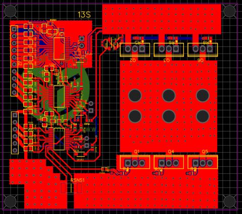

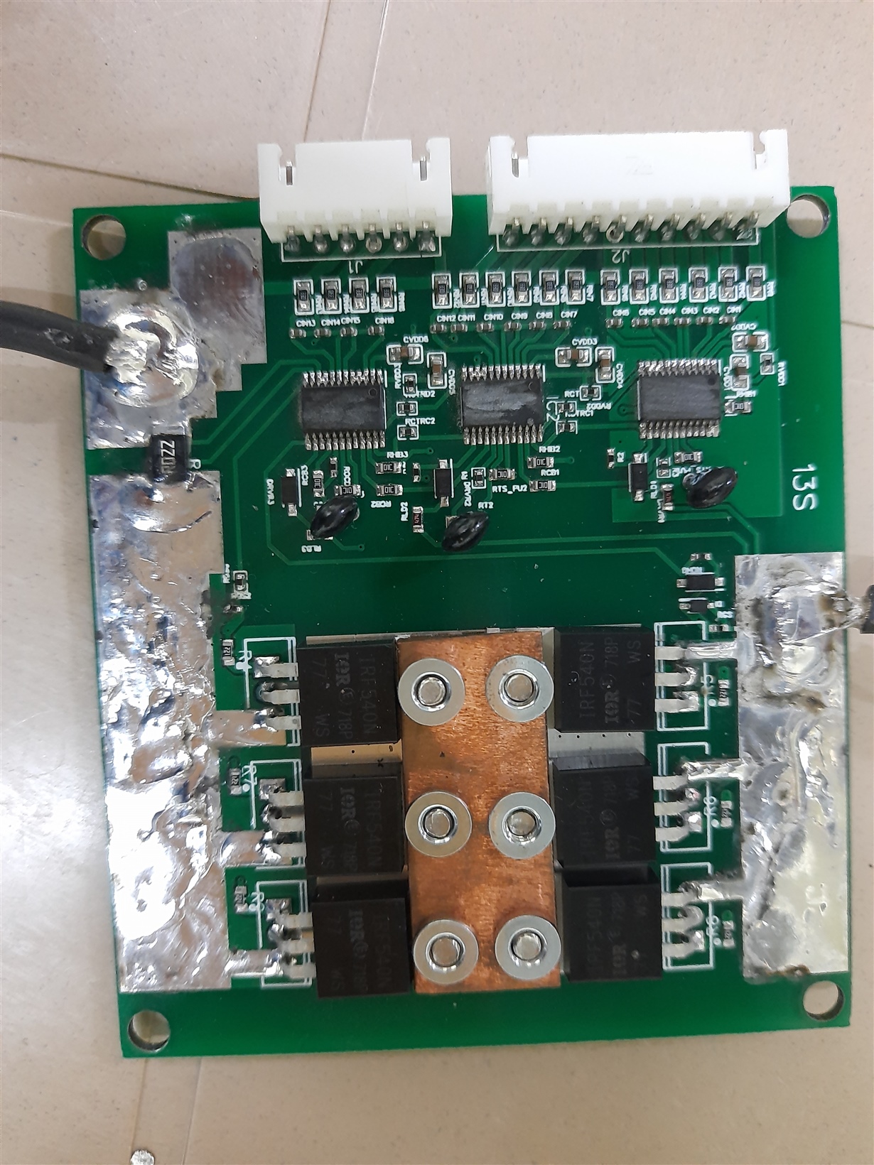

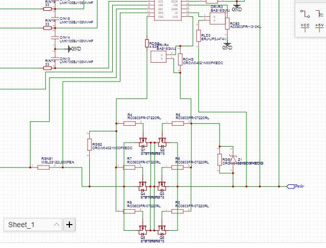

I have designed 13s Bms using three  bq791500 devices.  Finally I tested the Mosfet gate voltages  which around 9.5V but when the pack is loaded ( either connected to charger or discharged), Bms is turned off automatically.
》 I used 2.5milli ohm current sense resistor , all charging and discharging are under limits of 6 amps..I previously designed 10s BMS ( i used same 2.5 milli ohms without ant filters), which is working well.  Could you please guide me what  be the possible problem ,
》 I used 6 Mosfets ( 3 dsg mosfets 3 chg Mosfets ), Please attachment of picture
