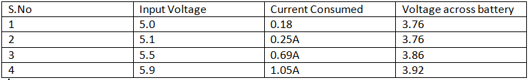

EN1 -0V ,EN2 -5V,TS - 0.6V,-ILIM 1K i had only 1K instead of 1.1K in my stock, R-ISET 866 ohm,\
I wanted to charge my battery at 1A because i am using 2500mah,3.7V and i want to charge my battery in 2.5 hrs only.
Input is supplied from DC power supply Input voltage :5V
My problem is current consumed from DC power supply is never exceeding 0.2A,With this current battery took almost 6 hrs.  to charge from 3V to 3.8V(which is not even full capacity of battery).How to set the fast charge current to 1A, So that my battery will charge in 2.5A considering no Efficiency loss.
If the input voltage supplied is 5.9V current consumption increased from 0.2 to 1A. but the PCB is getting heated up.
Am I doing anything wrong?
Please Help.

    Can you confirm that the IC is seated properly on the PCB without any shorts? What is the battery voltage when the current increases from 0.2 to 1A?
    I would also like to note that the charge current range for this device is maxed out at 1.5A. If you are looking for a higher charge rate, I can direct the correct support to this issue or recommend a device.
    Yes IC is properly seated and No shorts.
    I have connected volt-meter across battery and below are the readings.
    Sorry I mentioned "(How to set the fast charge current to 1A, So that my battery will charge in 2.5A considering no Efficiency loss.) 2.5A  previously correct sentence is  "How to set the fast charge current to 1A, So that my battery will charge in 2.5Hrs considering no Efficiency loss"
    PFA
    After performing all the above tests  & measuring voltage after disconnecting battery from the circuit voltage across battery is 3.72V.
    After reaching 3.7V battery stopped consuming current when input voltage is 5.0/5.1V and consuming 10mA if input voltage is increased above 6V
