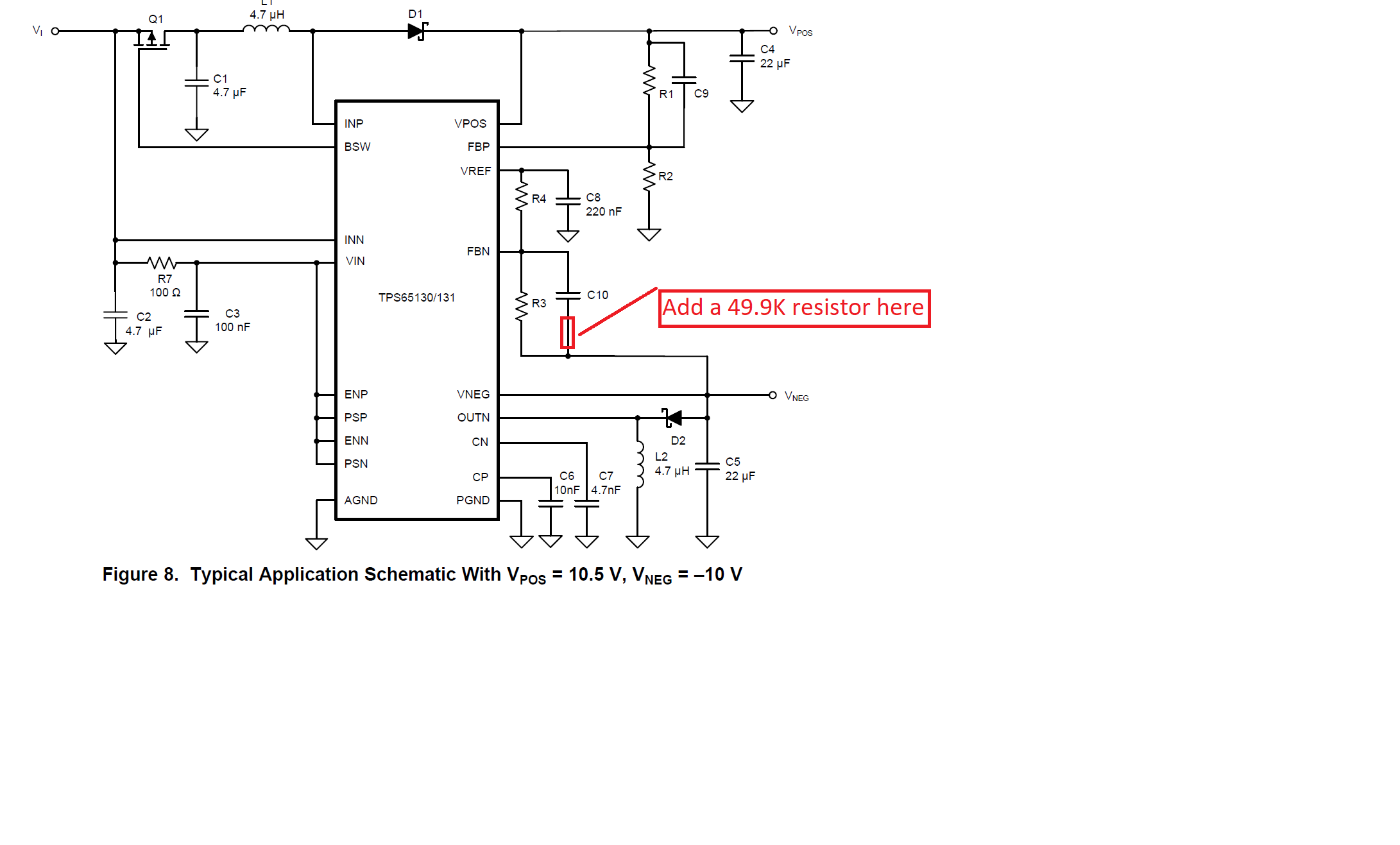

I designed power module, +5v input, +/-15V output with  TPS65131 , I  layouted  2 version PCB, but the module can't work normally.
The 1st version PCB with 2level, output +15v and -15v without load, the positive output can drive a load with 100mA with +14v,  but the negative become -2v with a load.
The 2nd version PCB with 4level, output +15v and can output 100mA , the positive output  is good with a load.  But the  negative  output is wrong,  it is  -24v without load and -2 v with a 1mA 。
My PCB size is very small, 10mm *1mm, I am not sure if TPS65131 is  suitable for such size PCB.
I attach our PCB file, kindly please help to check the PCB,  or confirm if  we can apply TPS65131 for my project.
