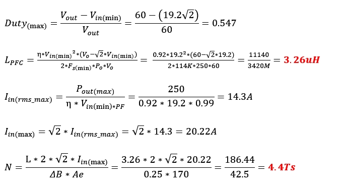

Could you help to review if there is any problem for my customer PFC design?
Thanks.
AC19.2V ~ 31.2V ( Vnom = AC24V )
PFC boost to 60V
DC Output 12V/21A
PFC Transformer : PQ3220 / 3.3uH / 4Ts

Hi Peter,
UCC28180 is a fixed frequency CCM controller, it is not the same as LD7591, the PFC inductor is a around 30uH.
please do not use LD7591 as a calculator, TI has a an excel calculator for UCC28180.

Hi Peter,
from the calculator, the PFC inductor value should be at least 24uH. So I suggest you can follow the calculator to redesign the PFC inductor.
