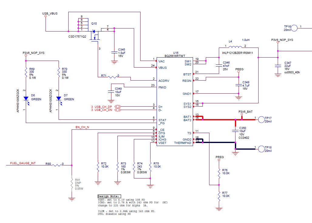

The BQ25616RTWT cannon keep the constant current, we select 2,98A ILIM with a 160 ohm resistor.

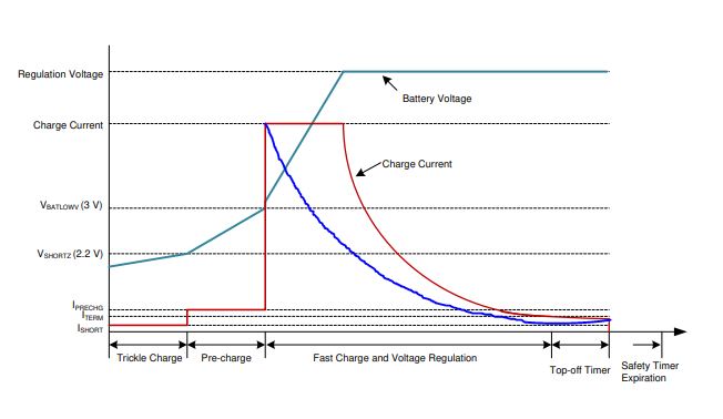

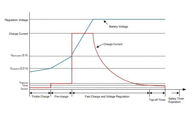

The battery starts charging at 2.67A but the current start decreasing, the current is not constant, the expected behavior should be:
The behavior we see is :
our sch:
USB Data lines are disconencted:
Jose,
It appears you might be in VINDPM.
What is the VBUS voltage (as close to the IC as possible)?
Or more simply, if you apply a 9V source instead of a 5V do you still see this reduced charge current?
Ricardo
We use a power supply at 9V and the current drops to 1.51 and the behavior is the same the current is not constant.
