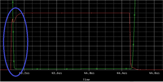

We are trying to run Spice simulations using the PSpice for TI tool in order to analyze the UCC20225A behavior. Nevertheless, it seems that the Dead Time (DT) implemented in the model is not working, as the two output signals (OUTA and OUTB) are overlapped, regardless of the resistor value connected on the DT pin. Please, find attached two images. Thank you in advance.

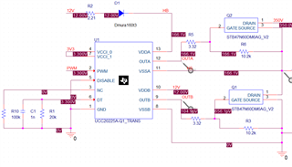

    I have been able to perform the simulation you propose and the result is correct. However, I am trying to simulate a circuit from the datasheet (attached image), and I cannot get the simulation right.
    The problem I see is that when VSSA is connected as in the attached image, that is, when VSSA is not connected to VSSB. In this case, the Dead Time is not generated well.

    Please find attached an image with the circuit from the datasheet which I want to reproduce. I have marked in red the main differences with your example. VSSA is not connected to GNDA as in your example, but is connected to the wire between MOSFET transistors.
    Thank you.
  • Hi Zhonghui Xu,
    Let me go ahead and check this new set up you have proposed. I will have a final answer here by Monday. It could be that our model is not working properly, and if that is the case I will request for an update on the model. But let me first try to do your recommended set up.

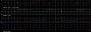

  • Hi Zhonghui,
    I was able to create the correct simulations based on the feedback you provided me.
    The following waveform shows the transient simulation until the output becomes stable and the voltage are well defined.
    The following image shows the expected DT behavior
    The following image shows a case in which the DT pin fails as you were suggesting
    Is this agreeing with what you see in your simulations? Do you see random failures as shown here or do you observe consecutive failures?
    I am going to reach internally to the Pspice model designer to request for this issue to be fixed for the next generation of devices.
    However, I was able to fix the issue by decreasing the PWM and decreasing the pulldown resistance to have a higher pull down.
    In this case the DT pin was behaving as expected during simulations. The two waveforms bellow show how the outputs will not be overlapping any further
