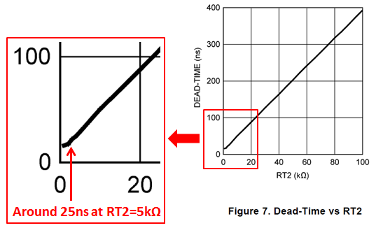

Hi Team,
Our customer would like to know about minimum dead time.
Could you please let us know if you have a guaranteed value?
I understand that we can set " Dead time =25ns at RT2=5kΩ".
So, I guess it is minimum dead time.
Is my understanding correct?
And, I have one more question.
According to the datasheet, the recommended range of dead-time is 50 ns to 250ns.
If I set " Dead time =25ns at RT2=5kΩ"(so less than 50ns), what kind of problem occurs for itself(LM25037-Q1)?

  • Hi Kanemaru-san,
    I spoke to the engineer in our office who has worked with the LM25037-Q1 and his recommendation is to follow the datasheet. Due to IC variation it may be difficult to guarantee that the minimum deadtime will be 25ns if you use an Rt of 5K. Internal delays may cause the dead-time to increase up to 50ns.
    The graph is for typical values only.
    Peter

  • Hi Peter-san,
    I'm sorry for asking your advice so many times.
    I have two questions.
    [Q1]
    Our customer would like to use RT2=4.7kohm(Actual value of dead time is 26ns) and RT1=1.5kohm(Actual value of switching frequency is 763kHz).
    Then, we have the following concern.
    - Does the internal oscillator stop?
    - Does the internal oscillator become unstable?
    We can’t guess the behavior of internal oscillator from the following block diagram.
    Therefore, could you please let us know if you have any information?
    [Q2]
    Could you please let us know the recommended minimum value of RT2?
    I understand that the minimum value of dead time is 50ns.
    Therefore, I guess that the minimum value of RT2 is 10kohm.
    I’d greatly appreciate your verification.
    Kanemaru
  • Hi Kanemaru-san,
    1. I run a bench test and see the controller can work base on the configuration you given, but this is not guaranteed as there is variation and tolerance between different parts. So the best way is follow recommandation of the datasheet which is verified in producation.
    2. Yes, I think your understanding is correct according to the equation (1) in the datasheet.
