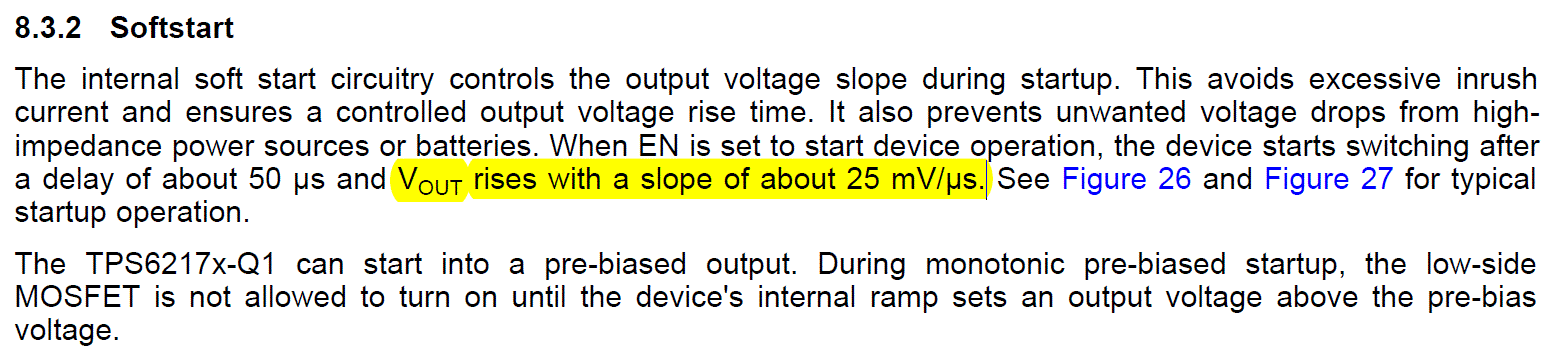

Could you tell me about the slew rate when the output is rising.
According to the datasheet, the slew rate of TPS62170-Q1 is 25mV/us.
Please let me know the max / min of this value.

    I made a mistake in the image, so I changed it.

  • This is not a "test parameter" therefor min / max values are not available. This value also depends on external parameters
    What is the customer main concern ? What do they want to achieve?

    Our customer is in the stage of collecting information before designing and are considering constants of external parts.
    Customers want information such as how much slew rate comes out by presenting specific constants.
    For example, I think that information such as how much the slew rate becomes by circuit conditions written in 9.2 "Typical TPS 62170-Q1" Figure 5 in the datasheet will be helpful.

    as mentioned, this parameter is not designed/characterized as a precise one. For the typical configuration,
    we have used in 9.2, our customer would need to consider a variation of about ±30% within the IC.
    Hope this helps to get an idea of usability.
