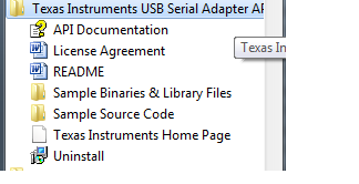

  • Well, there is no manual of the API functions and in .zip archive there is only executable.
    So, there is no any example on how to use it ???
    Sincerely
    Pavel.
  • after installing the tool, you will see the examples and documents shown as above.
    Yihe
  • Ok, thanks.
