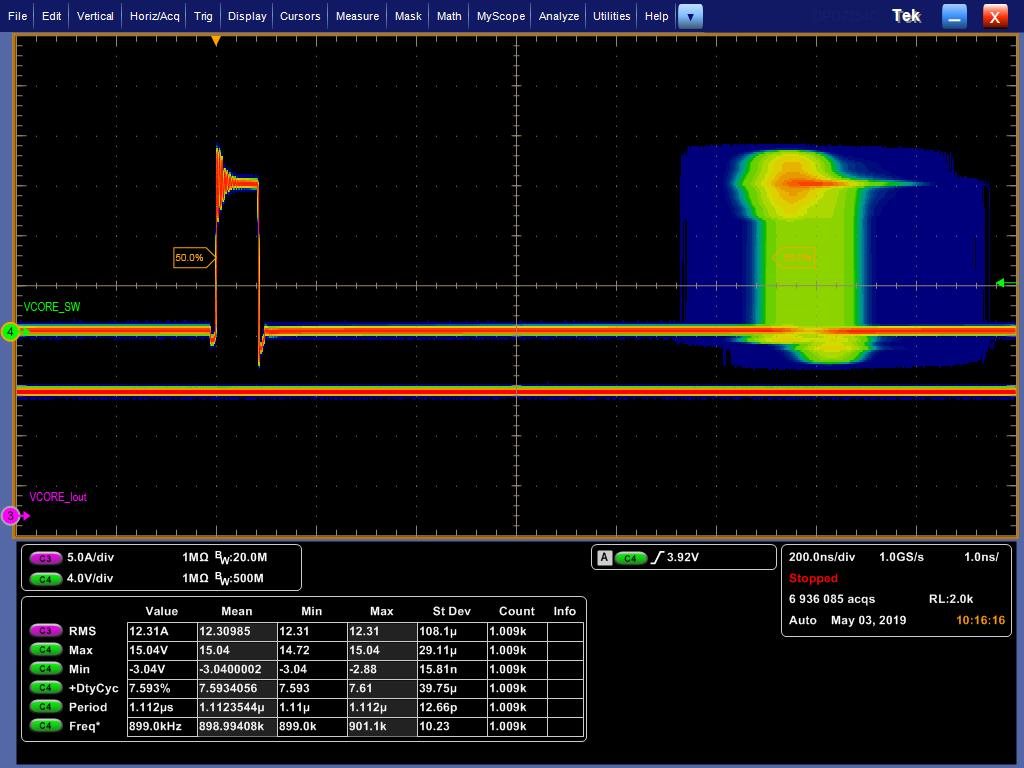

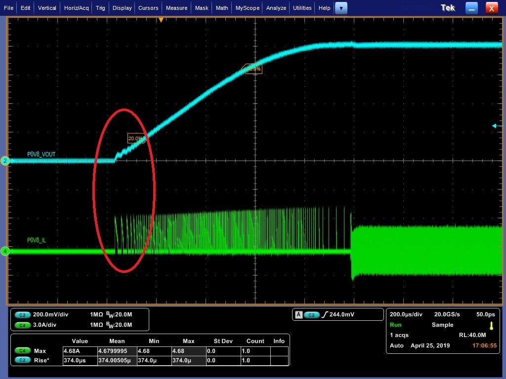

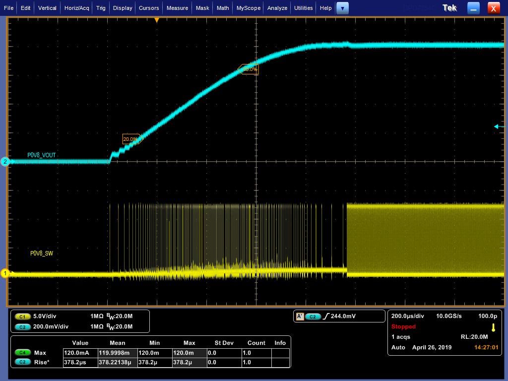

We use TPS548B22 converter for 12V to 0.8V solution. We found the start-up waveform is not smooth.
Seems the soft-start mechanism is not quite well because the first several duties are too wide during this period.
Is there any solution to avoid this? or it's not resolvable?
