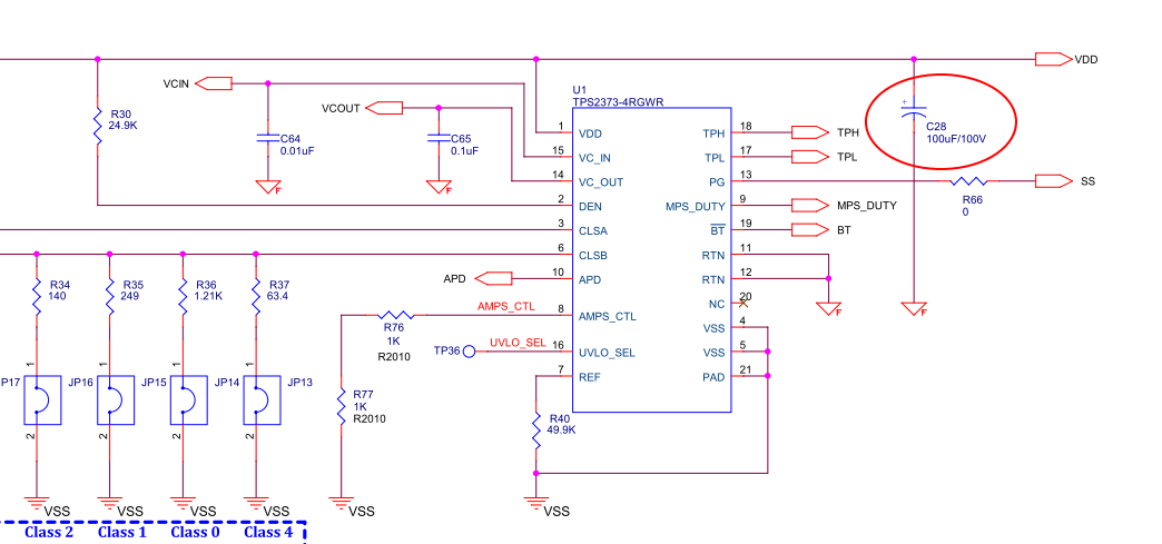

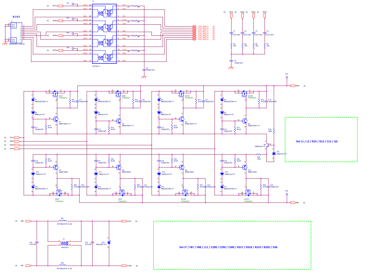

Hello
per below, if customer change C28 to three 33uF/100V for parallel. Has nay problem for it?
if customer not need external adapter, how to modify the schematics? Thank you.
BR
Patrick

Hi Patrick,
Yes they can have multiple electrolytic cap in parallel for the bulk cap with no issue.
For the adapter they can remove the all the APD and ADPT circuits as long as APD on the IC is pulled to RTN with a resistor.

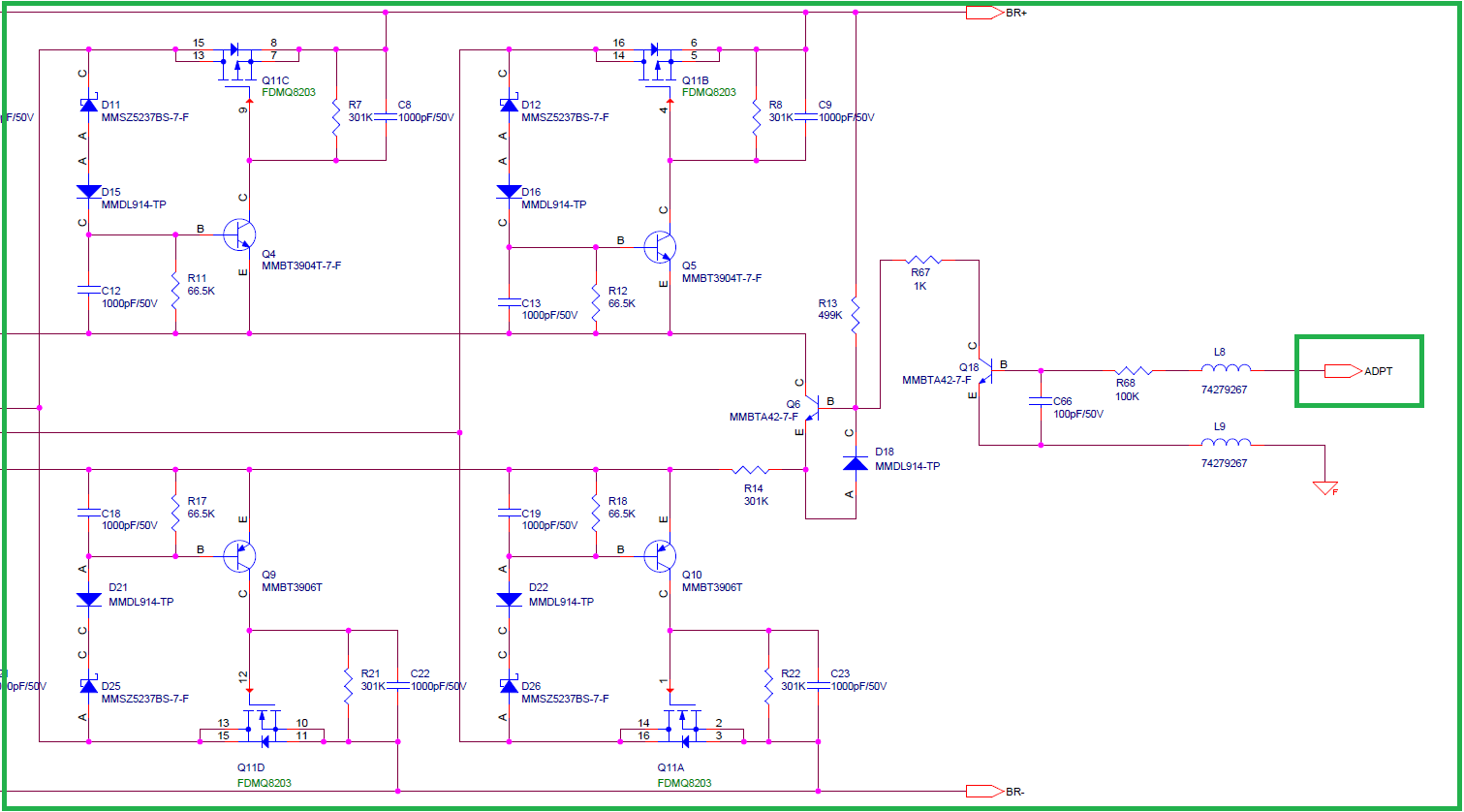

Hi Patrick,
Sorry for delay as i am out of the office. R67 up to L8 components can be removed if there is no adapter.
Why disable PoE if there is no other adapter? Is adapter on secondary? If so, you need to pull DEN LOW to disable PoE.
Like described in Figure 10 of the app note below.
Hi Patrick,
I see no issue with the components in the schematics if PoE is disabled. Be sure R29 is rated for slightly higher power since more current will flow through this resistor when the adapter is plugged in. Thanks!
