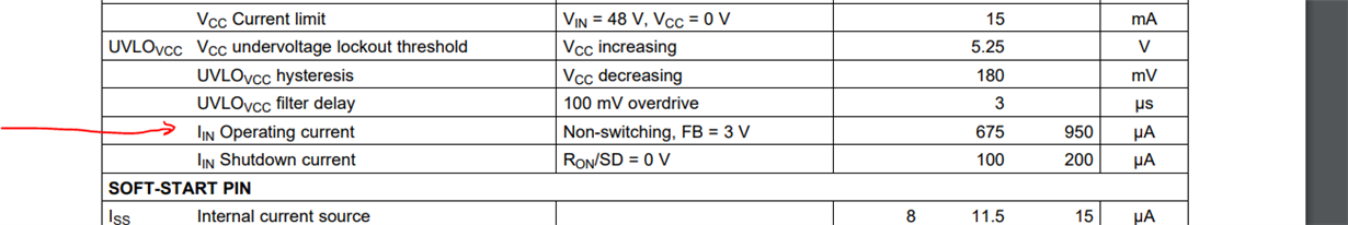

I would like to know what is Quiescent Current of this IC, as it is not stated in the datasheet.
Operation conditions are: Vin=36-60V; Ioutput=0.7A;Fswitching=175kHz

I was asking about the quiescent current of this IC, not efficiency
I saw you specifiy the output current, so I thought you mistyped.

Sorry, thats my mistake. Check the qGrade of LMR36006 below.
LMR36006-Q1

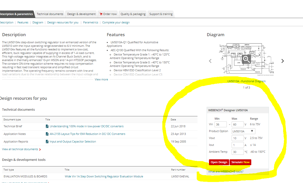

Hello Marshall,
What about the quiescent current of LM5010A-Q1?
I will have a look at the part you suggested
Hi Timur, you can assume the minimum of the maximum duty cycle to be 70%.
Unfortunately, we can not guarantee this specification by datasheet.
