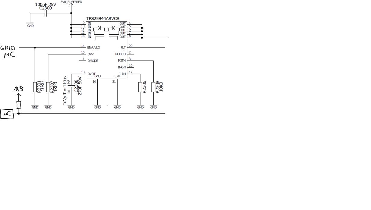

I'm using the TPS25944A as a power management device. I specifically chose the version TPS25944A to use the overcurrent shutdown mode. In the datasheet the following statement is noted:
" The TPS25942 limits current to the programmed I(LIM) level. TPS25944 does not limit current but runs the fault timer when I(LOAD) > I(LIM)." (SLVSCE9D –JUNE 2014–REVISED OCTOBER 2017, page 8, note (3))
In my application, I set I(LIM) to 1.1A. When I reduce the load resistance (potentiometer) to create overcurrent,  the load-current will be limited to I(LIM) and the device does not shut off after 4ms.
Is there a further configuration to be done to use the overcurrent shutdown mode of this device?
Thanks in advance!
Adrian
  • Hi Adrian,
    Thanks for reaching out!
    Can you increase the load further and check. Please share me the schematic and test waveform.
    BR, Rakesh

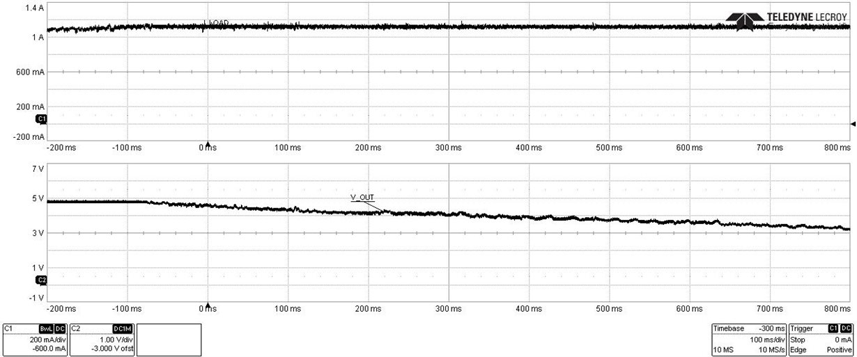

  • In reply to Rakesh:
    Hi Rakesh
    Thanks for the fast reply!
    I constantly increased I_Load using a potentiometer.
    After reaching 1.1A , I_Load remained steady.
    After the output voltage droped down to 3V and remained the load resistance was roughly 2.6Ohm.
    Best Regards, Adrian
  • In reply to Adrian Bucher1:
    Hi Adrian,
    Looks like the current limit response similar to TPS25942A device. To confirm, can you share the marking on the device and zoom-out waveform marked in RED below with time scale 100ms/div.
    BR, Rakesh
    Hi Rakesh
    Attached the device marking and waveform.
    Adrian
    Hi Adrian,
    Thank you.
    Is the input supply voltage of the efuse is stable and constant ?
    Rakesh
    To find the latest information on Power Switches, Visit www.ti.com/powerswitch
    Hi Rakesh
    The input voltage has a drop of roughly 200mV when I_Load is rising from 650mA to 1.1A. This drop is caused by the pcb track of the supply voltage. Besides that, the input voltage looks stable and constant.
    Adrian
    Hi Adrian,
    Thank you for the confirmation.
    It is behaving like TPS25942A device. Do you have local TI sales contact to submit these units for FA ?
