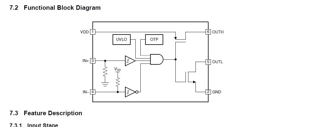

not clear on pin function assignment on this part.
  • Hi Poppy,
    Thanks for reaching out on e2e about LMG1025-Q1.
    Can you tell me which pin is unclear from datasheet?
    How are you using 1025 in your application?
  • Hi Poppy,
    Are you referring to the pinout of the part does not match the pinout of the functional block diagram?
    This is correct the functional block diagram should be fixed according to the top view image. Does this make sense?
    I'll go ahead and update the functional block diagram in the datasheet. Please let me know if there are any other questions or discrepancies.
