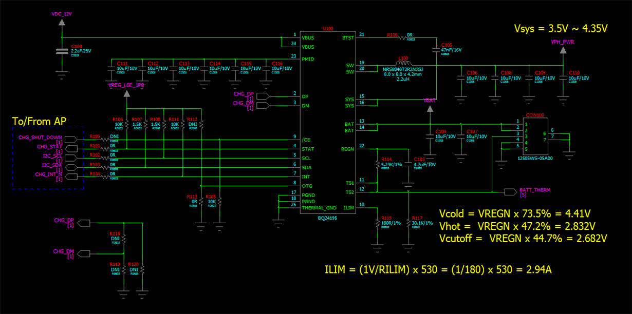

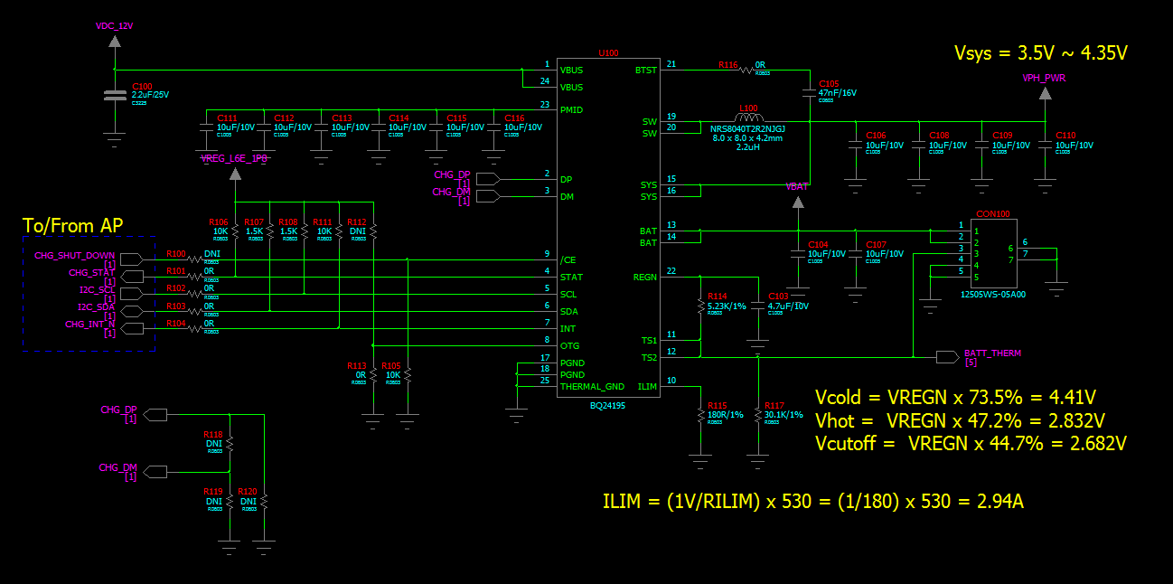

Hi TI team,
My customer designed BQ24195. They are testing standalone. (No host)
When VBUS = 12V input (no load), switching noise and high frequency noise of VSYS output are generated.
Please review the circuit diagram for any problems.

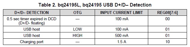

How to set the charging port in the default mode when I2C is not activated.
