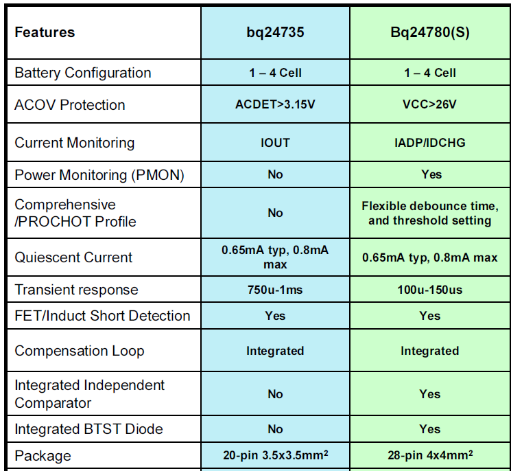

I have a question about the difference between BQ24780S and BQ24735.
It looks these spec are similar but BQ24780S is more cost effective than BQ24735.
Could you let me know these difference of spec?
