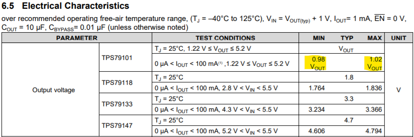

The reference voltage value of TPS79101 is 1.2246V, What is the tolerance?

The reference isn't specified directly since it is not accessible to the user. Instead we specify that output voltage will be within +-2% across line, load and temp since this is what the user actually sees in their application. Also keep in mind that any error introduced by your resistor divider will be added to that +-2%.
I've provided a quick image capture of the EC table showing the relevant spec, which is proportional to Vout (0.98*Vout to 1.02*Vout). The table formatting has moved the Vout to the next line due to limited horizontal space.

Thank you for the clarification. For TPS79101, if the resistors used in the voltage divider has 1% tolerance, what would be the expected minimum and maximum voltage output of the regulator?

From the explanation of Kyle about the the error introduced by the voltage divider, the customer now understands why the output voltage of the regulator is lower than the expected values.
