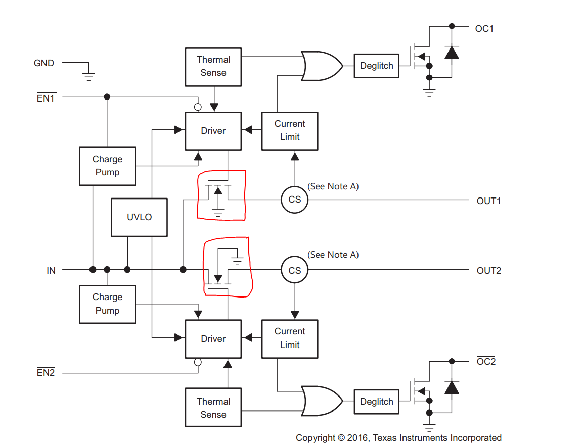

Is there any body diode of mosfet inside ? I draw at below picture with red square. I need this information because ı designed a circuit for protection output overvoltage.

    The block diagram is just a simplified circuit.
    In fact, the inside circuit is a back to back MosFET which both have a parasitic body diode.
    So as EN=0 or power off, the current or voltage can't flow to VIN.
    But as power on, will have reverse current or voltage flow through Mosfet if Vout>VIN.
