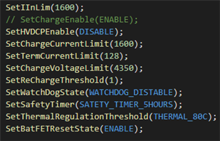

Below shows the configuration I set for BQ25890:
Thank you.

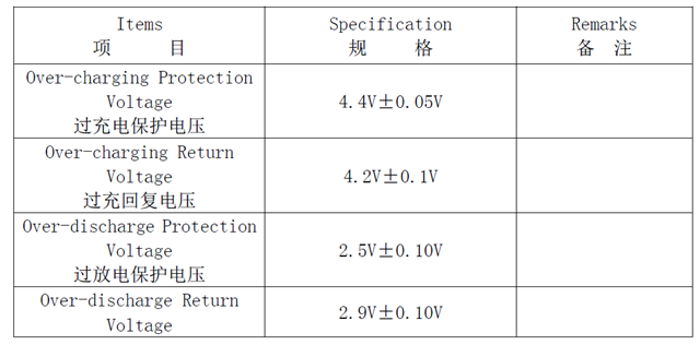

    Does the 3.0V battery have built-in battery protection?
    Ning.
  • Yes, I think so. It's a common battery which is used in smartphone.

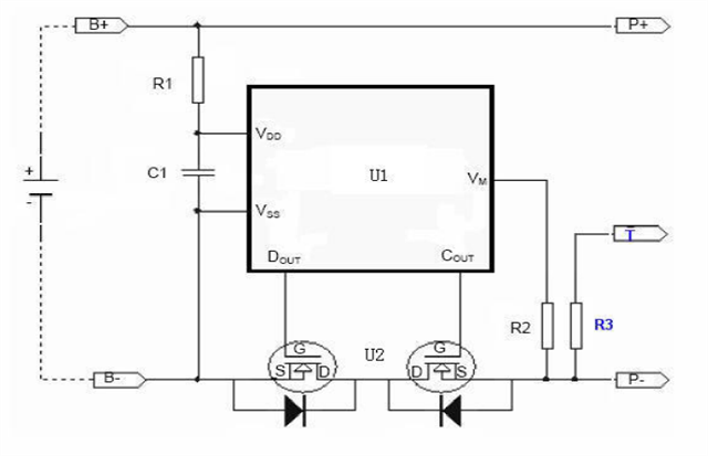

    2. Is there any battery protection circuitry in between BAT pin and the battery pack or does the battery have built-in battery protection?
    Ning.

          2. Yes, there is a protection circuitry.

    2. The battery protection may interfere with the charger operations (e.g. disconnect the battery from the BAT pin of the charger under certain conditions). For easier debugging, it is better to connect the battery to the BAT pin of the BQ25890 directly (i.e. bypass or remove any unessential components for charging operations).
    Ning.

         I find that the BTB interface is broken and does not connect well. And today, after I pull it off and plug it on for 2 times, it seperated from the battery.
         I think maybe this is why the battery does not charge, alrough the VCC and GND is connected, maybe the VTS signal pin of the BTB interface is not well connected with the battery, and maybe even shorted with VCC.
         I will change a new BTB and try.
