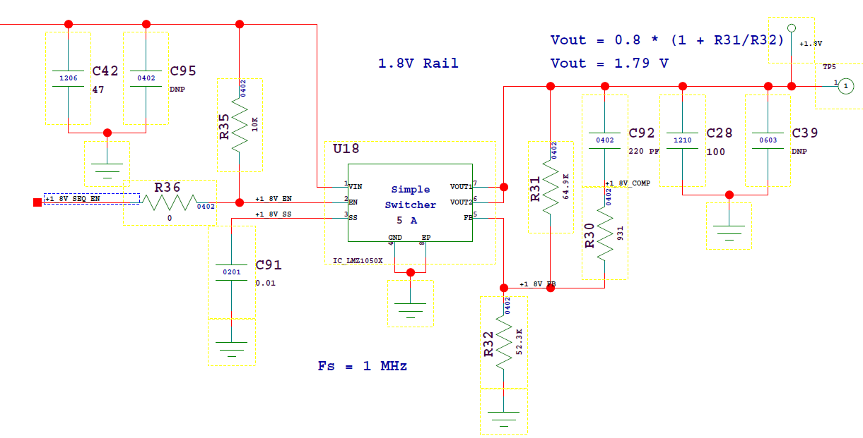

LMZ10505: LMZ10505 Part Failures experienced during system test and/or temperature testing of board
Part Number: LMZ10505
LMZ10505 being used to regulate from 5V down to 1.8V.
A number of these circuits have failed and it appears that the internals of the regulator have been damaged.
In a couple of cases it appears that the internals were damaged such that VIN is shorted to VOUT
In another case it appears that something happened causing the highside FET to always be turned on ---- causing the VIN to be tied to VOUT (but not switching)
We have captured some evidence of oscillation on the 1.8V output once we monitored the output with an oscilloscope over temperature testing --- a couple of hundred mV of ripple on the output at approximately 100KHZ
I'm attempting to verify compensation networks, component values, BOM items, but looking for any suggestions on items that could be tried to make the circuit more tolerant or forgiving.
Also ---- I'd welcome any input from folks with similar experience that could share their resolution to the issue.
Thank you.

  • Hi Dave,
    Can you provide me with the schematic and PCB layout that you are using for 5V to 1.8V conversion application? The LMZ10505 has external compensation and can be affected by noise. If the regulator is unstable and in a noisy environment, this could result in improper operation of the LMZ10505.

  • Jimmy -
    here is a clip of the schematic portion of the circuit...
    I will see if I can release enough of the layout to you in order for it to be useful.
