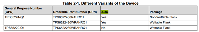

I am designing my board using TPS65224-Q1 PMIC
Are there some common recommendation or observations that i should be aware?
  • HI Board designers,
    Please refer below
    Q.1
    TPS65219: AM62P support
    Customer already use the TPS65219 today for an AM62x design and would like to re-use the same PMIC with the new AM62P.
    However, I see our recommendation is to use the new TPS65224-Q1 which is larger and more expensive.
    Is there any reason why the TPS65219 can't support the AM62P? Has any analysis been done to show any shortcomings?
    The input current requirements are higher for the AM62P than the AM62x, so the TPS65224-Q1 is required to meet these power requirements.
    You can see the power architecture in Figure 2-25 in this document: https://www.ti.com/lit/ug/spruja2/spruja2.pdf

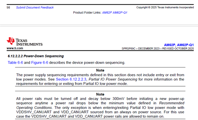

    Inputs regarding supply decay
    Refer below FAQ
    https://e2e.ti.com/support/processors-group/processors/f/processors-forum/1485094/faq-am62a7-power-rails-decay-note-in-latest-datasheet/5703704#5703704
    I have placed the note in both sections because it applies to both power-up and power-down. The power-up sequence should not begin until all power rails are below 300mV, and the power-down sequence is not complete until all power rails are below 300mV.
    Data Sheet reference
    Note
    All power rails must be turned off and decay below 300mV before initiating a new power-up
    sequence anytime a power rail drops below the minimum value defined in Recommended
    Operating Conditions. The only exception is when entering/exiting Partial IO low power mode with
    VDDSHV_CANUART and VDD_CANUART sourced from an always on power source. For this use
    case the VDDSHV_CANUART and VDD_CANUART power rails are allowed to remain on.

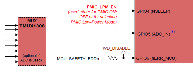

    My customer has selected our TPS6522430RAHRQ1 to power AP62P-Q1 in a headlight domain control unit project.
    After the customer got their board and powered it on, they found that the output voltage would be pulled down in a cycle of 1.1s, and each low output lasted for 100ms. After repeating for 12s, the output was completely turned off.
    Before debugging, the customer made the following changes on the board:
    Directly connect Pin 17 to an always 3.3V power rail.
    Directly connect GPIO 6 to an always 3.3V power rail.
    The customer currently suspects that the problem may be related to the watchdog in PMIC. Could you please help analyze the possible root cause of the problem?
    If it is indeed related to the watchdog, is there any way to turn off the watchdog?
    have they checked the user's guide for this configuration in secure folder? We just released a new version of this document which should be better than the original. They can request access here.
    This doesn't seem to be watchdog issue since the default long window is 12 minutes long so if they don't start servicing it, it will not timeout this fast. I suspect they have orderlyOff2Safe sequence happening because it has this 100ms delay before starting up again. This is caused by almost every rail in the PMIC and also some internal features.

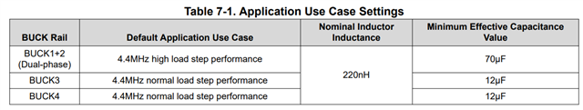

    I see that they have 1uH inductors for the bucks which is not a recommended value. For 4.4 MHz in this configuration the only recommended inductor value is 220nH. This could cause the output to be outside of the voltage monitor range and cause UVOV interrupt which would cause orderlyOff2Safe sequence.
    Also they only seem to have 4.7uF capacitors at buck inputs as the recommendation is 10uF with minimum allowed capacitance of 3uF so if these 4.7uF capacitors derate too much they could go below this and cause issues.
    Is customer aware of the use-case selection this particular OTP has? This device has four different use cases which are selected by GPIO3/4 external resistors. Please see the user's guide for more information. I don't see an issue due to this though.
    The watchdog can be disabled (WD_PWRHOLD=0x1) by pulling GPIO6 high before (or at the same time] supplying the VCCA for the PMIC. This is explained in the user's guide.
    GPIO6 is used for the watchdog disable/power hold feature. The state of this pin is evaluated as soon as the enable pin goes high.
    GPIO6 LOW: watchdog enabled
    GPIO6 HIGH: watchdog 'disabled' (power hold, long window doesn't expire)
    Customer should read the interrupts of the PMIC somehow as it will most often lead to the root cause. If they can't do it with on-board MCU then they can use external device similar to usb2any. If this still isn't possible then I would like to see the power up sequence measurement to see if some rail is not powering on correctly or doesn't reach the correct operating voltage.

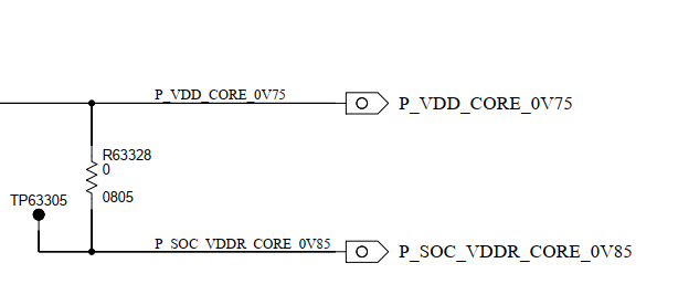

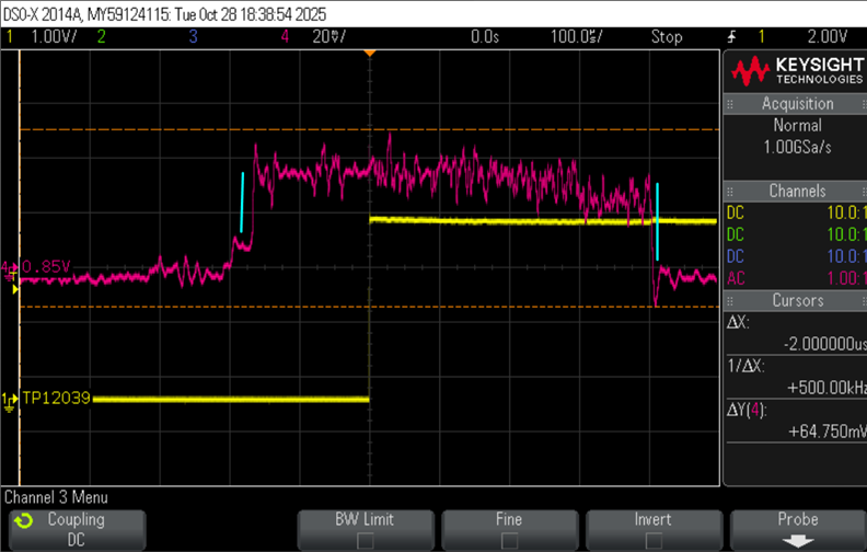

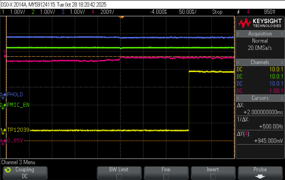

    FYI, Effect of feedback on the voltage level
    We have OPV triggered on VDDR_CORE, not VDD_CORE . Here is a snapshot triggered at level 0.945V.
    AC portion:
    The issue is caused by the fact we have separate power rails for VDD_CORE and VDDR_CORE:
    We have remote sensing on P_VDD_CORE_0V75, so PMIC keeps that point at 0.85V and when there is a current consumption on VDD_CORE, PMIC increase it`s output voltage in order to keep the far end at 0.85V.  R63328 is closer to the PMIC output capacitors rather than P_VDD_CORE_0V75 sensing point and this is why it jumps with ~40mV DC (marked in blue on the second diagram) and then the ripple voltage triggers 0.95V threshold. We will have a board spin to fix this for sure,

    currently we only have TPS6522x-Q1 which is automotive and functional safety device (ASIL-B) and TPS6522x which is industrial functional safety device with SIL-2 rating. We don't have non-functional safety version of this PMIC.
    The TPS6522x PMIC supports two switching frequencies and three performance levels but these settings need to be configured in the default OTP. Designing for a different switching frequency and external components require a new PMIC orderable with custom OTP settings.
    for TPS6522430: to disable the watchdog GPIO6 must have an external pull-up resistor to VIO (3.3V). Please note, the state of GPIO6 must be set before the PMIC is enabled.
    https://e2e.ti.com/support/power-management-group/power-management/f/power-management-forum/1574412/tps65224-q1-watchdog/6063907
    I have a customer designing AM62P boased board using TPS6522230WRAHRQ1.
    The SK uses TPS6522430WRAHRQ1
    Can you help me understand the difference between the 2 PMICs and if there are specific design considerations to be followed.
    The difference between these two OPNs is just that the TPS6522430 has an ADC and GPIO5 is used as the ADC input, vs TPS6522230 does not have ADC and GPIO5 is unused - that is the only difference. Please refer to the document User's Guide for Powering Sitara AM62P/A/D With TPS6522430-Q1 and TPS6522230-Q1 PMIC (SLVUCV9) in the secure folder (needs permission for access)  https://www.ti.com/secureresources/TPS6522X-DESIGN-RESOURCES for more information about these configs - it includes a couple of notes about ADC and GPIO5 throughout as rest of the document applies to both part numbers.
    If the outputs of "BUCK1+2" and "LDO3" are shorted, what will happen to the PMIC?
    ・Both "BUCK1+2" and "LDO3" have an OTP of 0.85V at 0.85V.
    this would probably lead to an UVOV interrupt on one of the rails and the PMIC would perform an orderly off power down sequence. When the low side switch of the buck converter would be on it will connect the switch node to the ground but now the LDO would be connected to the output it would draw current from the LDO.

  • Hi Board Designers,
    Inputs related to power supply slew
    (9) AM6548: Confirmation on slew rate - Processors forum - Processors - TI E2E support forums
    Per the datasheet for the AM6548, the maximum slew rate is recommended to be less than 100 mV/µs for supplies in general, and less than 40 mV/µs for the VDDA_1P8_SERDES0 supplies. Alternatively, the slew time must be greater than the supply value x 10µs, and greater than supply value x 25µs, respectively.
    Just to confirm, this slew rate does apply for both rise and fall times?
    The max power supply slew rates requirement defined in the datasheet only applies when the power rails are ramping up. The ESD circuits implemented on the power rails may false trigger, clamping the power rails to VSS if the power rails ramp too fast.
    Sreenivasa

    we use PMIC TPS6522430 to power for SOC AM62A7-Q1.As per SOC AM62A7-Q1 has no ADC function.So we will try to use the GPIO5 as the input for ADC with TMUX,refer to the PMIC users guide.
    Are there any restrictions of the ADC function? will it  seriously increase the load  of I2C1?
    • The maximum voltage on GPIO5 also in ADC mode is VCCA and not 7.2V as stated in the data sheet even if the integrated resistive divider would be used.
    • GPIO5 is in LDOVINT domain so when input voltage to this pin exceeds 1.8V it starts to leak somewhat so it could affect the measurement but not greatly.
    • If integrated resistor divider not used the maximum input voltage is 1.2V but around 1.2V the ADC will reset and the ADC will read 0 value. For this reason it is recommended to not go over 1V which is anyway the accurate range.
    Using the ADC will not increase the I2C load by itself but if the software is implemented to poll the ADC value or initiate single conversion often then of course the load is increased.
    Here is a summary of the I2C connections between SoC and TPS6522430-Q1PMIC:
    • The I2C1 is used for all non-watchdog communication, such as voltage level control, and the I2C2 allows the watchdog monitoring to be on an independent communication channel.
    • PMIC I2C1 (I2C1_SCL/SDA) can be connected to the processor WKUP_I2C0.
    • PMIC I2C2 (GPIO1 / GPIO2) can be connected to the processors MCU_I2C0 when watchdog is used in Q&A mode.
    • If watchdog is used in trigger mode, I2C2 is not needed and GPIO2 can be reconfigured into TRIG_WDOG.
    • Here is the link to access the TPS6522430-Q1 user's guide: https://www.ti.com/drr/opn/TPS6522X-DESIGN-RESOURCES

    3. 220nH coil
    It is recommended to use 220nH inductor for the three rails, how do you get the value, is there any calculation steps or tools?
    1. For AM62P we have the TPS6522430 configuration for which you can find the user's guide in the secure folder. By default this is configured to use the Q&A watchdog over the I2C2 bus but it can be reconfigured. The Q&A watchdog can be served either by I2C1 or I2C2 bus (physical connection) but in both cases the I2C2 address has to be used.
    2. AM62P is powered with TPS6522430/TPS6522230 configuration. The TPS6522312 configuration is for J7/TDA4AEN.
    3. There is no formula for this since these bucks have been designed from the ground up to support either 220nH or 470nH inductors for 4.4MHz and 2.2MHz, respectively. This means we have also only simulated and validated this device with these two inductances and customer should use these values for the specific switching frequencies. It is still ok to use for example 240nH but we don't recommend customers calculating their own inductor values as the device might not achieve the data sheet performance with other values.
    Customer wants to know if they don't use ADC function, can they use TPS522230-Q1 powering for AM62P? Which may be better in cost than TPS65224.
    Any other difference for the two parts?
    yes this is correct. There are no other differences between the devices but as the ADC is omitted in TPS6522230 the GPIO5 pin is not used by default for anything.
