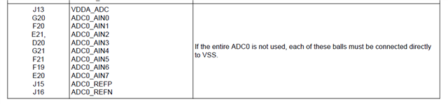

     Note that the processor family ADC inputs are not fail-safe. Do not apply external inputs before the processor supplies ramps and are stable.
    Refer pin Pin Connectivity Requirements section for connecting the ADC inputs when complete ADC is not used or any of the ADC inputs are not used

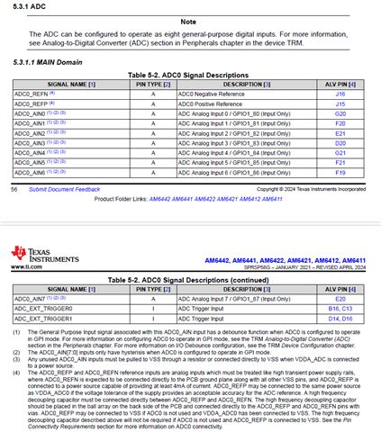

    4.ADC inputs used as GPI
    The ADC inputs are connected to the AM64x/AM243x (ALV) GPIO1 module when configured to operate as general-purpose inputs (GPI). The assignment of each ADC0 pin to the GPIO1 module is defined in the ADC0 Signal Description table found in the datasheet.
    These inputs are able to perform the same input function as any other GPIO1 input. Please read the GPIO sections in the TRM to understand the capabilities of these inputs.

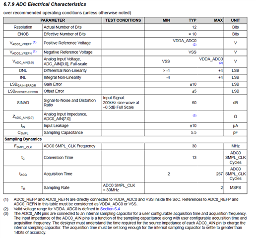

    AM62L
    1. Supported ADC resolution and channels
    – Speed up to 8Mbps
    • 1x 12-bit Analog-to-Digital Converter (ADC)
    – 10 bits of effective resolution (ENOB ≅ 10)
    – Up to 2MSPS
    – 4x analog inputs (time-multiplexed)
    2. Guidelines for using ADC peripheral
    3.ADC0 input range
    VADC0_VREFP Positive Reference Voltage = VDDA_ADC0
    VADC0_VREFN Negative Reference Voltage = VSS
    The ADC0 module does not support separate VADC0_VREFP and VADC0_VREFN pins

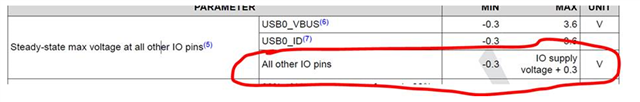

    Power supplies that are available before SOC supplies are available are connected to ADC. SOC ADC inputs are not fail-safe. No inputs are recommended or allowed to be applied before SOC power ramps
     Customer comments:
    Does that mean that we cannot measure voltage such as V0P85_CORE, V1P8_MPU_ANALOG, V1P1_LPDDR4 V3P3_MPU_IO, V5P25_SMPS and +16V since they are available before the SOC are power up? As you can see, all these voltage already go thru voltage divider with a small cap that will slowly ramp up the circuit, will that helps to “protect” the ADC internal circuit. Isn’t these ADC input high impedance? Is there a ADC input tolerance?
    Expert inputs
    The answer to the above question is addressed by the “Steady-state max voltage at all other IO pins” parameter found in the Absolute Maximum Ratings table.
     They need to implement a switch or clamp circuit on each ADC input signal that blocks any potential from being applied to any of the ADC0_AIN[7:0] inputs before the supplies powering VDDA_ADC and ADC0_REFP are valid.  The rate of charge of their filter capacitors and the power supply ramp rates have too much variability for the capacitor delay option to be a robust solution. Without blocking the potential, there will be some potential applied to the ADC inputs as soon as these early power supplies begin to ramp and this is not allowed if the potential applied ever exceeds the Absolute Maximum Ratings limits, which is shown below.

    Suggest reading the note below if the ADC0_REFP and ADC0_REFN pins were not connected.
    The ADC0_REFP and ADC0_REFN reference inputs are analog inputs which must be treated like high transient power supply rails.
    ADC0_REFN is expected to be connected directly to the PCB ground plane along with all other VSS pins, and ADC0_REFP is
    connected to a power source capable of providing at least 4 mA of current. ADC0_REFP can be connected to the same power source as VDDA_ADC0 if the voltage tolerance of the supply provides an acceptable accuracy for the ADC reference. A high frequency decoupling capacitor must be connected directly to the ADC0_REFP and ADC0_REFN pins with vias and be placed in the ball array on the back side of the PCB.
