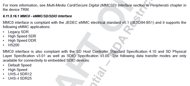

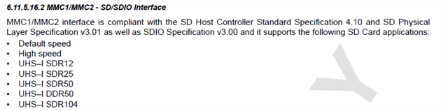

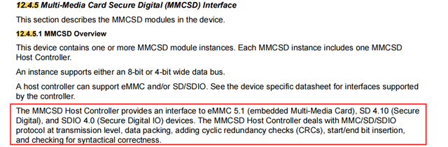

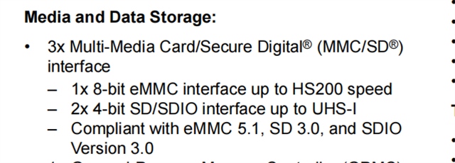

Do all three MMC/SD buses support eMMC 5.1, SD 3.0, and SDIO Version 3.0?
2、What does the content shown in the following picture mentioned in the TRM manual mean? Does it support SD 4.10 and SDIO 4.0? So, should we follow the data manual or the TRM?
The next revision of the AM62Lx datasheet will be updated to show with the following list of devices and data transfer modes supported for each MMC instance.
The MMC0 port supports connections to an eMMC device or embedded SDIO device. It does not support removable SD Cards.
The MMC1 and MMC2 ports support connection to a removable SD Cards or embedded SDIO device. They do not support eMMC devices.
For the SDIO specifications, please follow the data sheet.
The references to 4.x in the TRM will be updated.
