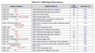

I am using the 66ak2g12. But the USB is not used at all.
Can you please confirm the pins in the list to be float or short or pulled down to GND as described in the attached table (see notes in red):
I seek to make the card reduced noise as I can. Is it possible to short to GND  B19, A21 (VBUS)?
It was written in the forum that the USB0_TXRTUNE_RKELVIN, pins C19 and C20 to have the 200 Ohm resistor. can that be avoided if the USB is not used at all ?
