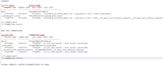

    Yeah, you can boot my test app but I can not. This is strange . I have checked my boot setting, it's OK.
    And I also use mcusw for test, it can be boot by SBL, see logs below . I don't why this is OK but DioApp is failed.
    Can you send me the whole files that in your SD ? I try to replace every files in my SD and see what happens.
    And I found in the SDK build , the default instruction is Thumb.  This is OK? If I want to change to ARM instruction to build PDK and example, How can I build ?

    I just looked at the mcusw/binary/dio_app/bin/j721e_evm/dio_app_mcu1_0_release.xer5f.map to see the DDR region being used. There is a region by the name DDR0_MCU1_0 which starts at 0x97000000, you can put that address in the memory browser.
    But add the while() loop first in the app and recompile.
    Karan
  • Hi Karan,
    I debug the dio_app code, I found it crash in __mpu_init function.
    Below log.docx file is the detail information that I save from the step by step run.
    Not sure why this happened . Wait for your response.
    j721e_evm.rar is the bin and map.
