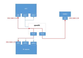

    1. Configure the CPSW9G host port and port5  supports VLAN ID 2,4,13
        eg.1  When a vlan packet is received from host/port5 , it is directly trunk to port5/host without any processing
        eg.2 When an untagged VLAN packet is received by any port, it will be relayed directly to the corresponding port without any processing
The network topology is shown in the figure
