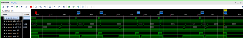

The custom board design housed with an AM3359 processor connected with an FPGA over GPMC interface, which is operating at 100MHz, Synchronous & Multiplexed mode, in AD (Address & Data: 16 bit) configurations.
The AM3359 processor is running with Linux SDK v6.1.
There is an issue with read transactions with address field increment is improper. Whereas, for write transactions the data & address field are proper.
  • Read transaction: Address (ex. 0x10000008) + LSB Data + Address (ex. 0x10000008 - Expected address is 0x1000000A) + MSB Data + Address (ex. 0x1000000A - Expected address is 0x1000000C) + LSB Data + Address (ex. 0x1000000A - Expected address is 0x1000000E) + MSB
Write transaction: Address (ex. 0x10000008) + LSB Data + Address (ex. 0x1000000A) + MSB Data + Address (ex. 0x1000000C) + LSB Data + Address (ex. 0x1000000E) + MSB

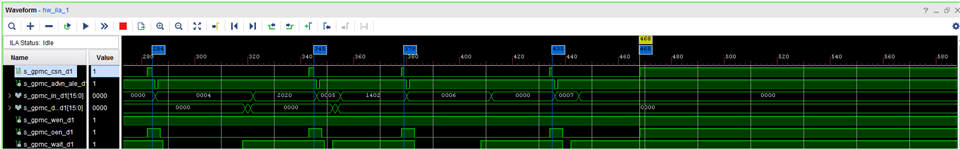

Attached the screenshots of the Write and Read transactions.
Please help to correct the configurations and make read transactions proper.

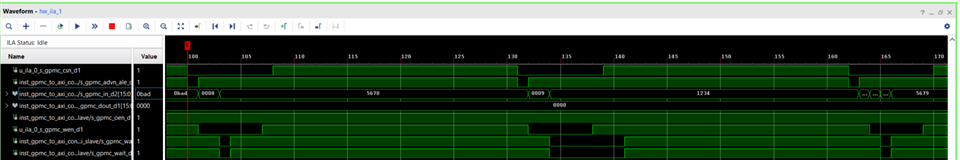

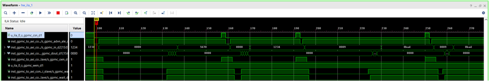

    I have one observation to share related to read transaction, the above shared read transaction picture is performed by using the memcpy api to read multiple bytes. In this case the address is getting repeated twice and then incrementing.
    Please share your thoughts and inputs on this.
  • Hi Mark,
    I have one observation to share is that read addresses are proper when memcpy is replaced with 8byte pointer.
    My doubt was how memcpy effecting the GPMC address generation?
    Any other alternates which can be used in place of memcpy for this gpmc scenario?

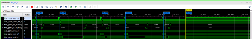

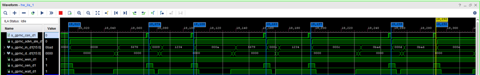

    One more observation from screenshots:
    First 8 * 16-bits clock ticks - 100 to 468
    Second 8 * 16-bits clock ticks - 18013 to 18379
    Third 4 * 16-bits clock ticks - 25126 to 25276
    There is a lot of gap among every 8 * 16 bits (Please note each tick corresponds to 10ns).
    In the case of write transactions, memcpy address increment is proper.
    My doubt was how memcpy affecting the GPMC address generation for read transaction?
    Any other alternates which can be used in place of memcpy for this gpmc read scenario?
