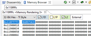

  • Hi Hi Shankari G
    Now i'm getting further with my code where I think it success for my to launch the code on core 0 and knock on the core1.
    But as your description the the BOOT_MAGIC_ADDR of core0 contains the entry point of the core1 (in this case the function call:write_boot_magic_number). Core0 generate an IPC interrupt to wake core1 and then core1 will start executing from the entry point and then write "BABEFACE" the address  0x1187FFFC.
    In my code i can run so far that i can see:  0x1187FFFC.=> 0xBABEFACE
    But what i expect if the "write_boot_magic_number" if the entry point of core1 the i've tried to modify the code to count up a variable in an infinite code:

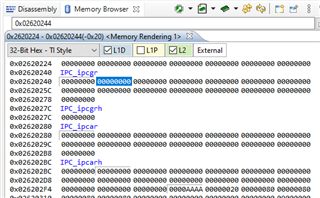

  • Hi Shankari
    Thanks for your anwer. It makes sense that i've always read 0 by ready from the KICK reg.
    I'm using a custom board and all DDR and PLL was configured correctly. The same board that we have use for TMS320C6655 platform. Now we are talking ablout upgrade to TMS320C6657 dual core.
    Let's move further with the code: we have 2 cores of our platform (C6657)
    - My write_boot_magic_number function was placed in memory: 0x0083A300 (the address is retrieved from the map file after a successful build)
    - After writing the entry address of Core 1 (second core) using the macro:
    CPU_REG_WRITE_32(BOOT_MAGIC_ADDR(1), (uint32_t)write_boot_magic_number)
    then the address 0x118FFFFC read with Jtag = 0x0083A300. Also the same address of the "write_boot_magic_number" function. "write_boot_magic_number" was intend to be used as the entry point of the Core 1
    - platform_delay(1); // delay 1usec

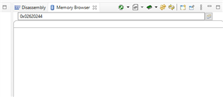

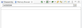

    - Then IPC interrupt is generated to knock on Core 1: DEVICE_REG32_W(IPCGR(1), 1)
    - platform_delay(1000); // delay 1msec
    - Then i've tried to read the IPCGR address of Core 1: 0x02620244: then it shows the value = 0
    - The core 1 didn't be waken op and the write_boot_magic_number was been called
    Should a read of IPCGR register (in this case 0x02620244) returns alway 0??
    Why the write_boot_magic_number didn't run while Core 1 has been waken up?
    Plead advise
    BR
    Tam Tran
  • Hi Tam,
    Your steps seems to be correct.
    Tam :
    Shankari : In CCS, connect core 1 and see what happens. Please post your CCS window along with memory browser.
    Follow the sameway, that you connected Core 0 with CCS. And do not disconnect core 0.
    -Shankari

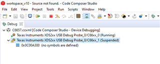

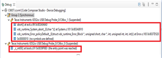

  • Hi Shankari
    Here is the screen dumps: core 1 seems to be in suspended mode
    and the memory browser when i choose the core0:
    memory browser when i choose the core1: nothing shown
    BR
    Tam Tran
  • Tam,
    Have you tried connecting the core 1 as I mentioned in my previous message?
    In CCS. right click on core 1 and connect core 1.
    By connecting core 0, are you able to see the values of the variables in the debug window and the values of the memory address in the memory browser window?
    -Shankari

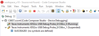

  • Hi Shankari
    yes i did
    When i've tried to browser the same memory area then there is nothig to show:
    The core 1 seems to be "suspended" even it should be waked by IPC interrupt
    BR
    Tam Tran
  • Hi Tam,
    In your picture of CCS. why does it say the source not found? for Core 0 in running state!!
     I am running out of ideas.
    However, when I looked into the SW package for C6657, there are many sample boot projects like below. The CCS project files are also available to directly import and build. Try those boot examples and check whether there is no problem in JTAG/CCS etc.
    By running these sample programs, atleast we will verify that the debug window in CCS displays all the variables, values etc and Jtag is fine!!.

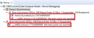

  • Hi Tam,

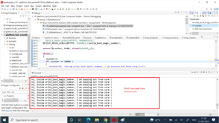

    In, C6657 EVM, I experimented the code with Boot magic address and tested whether the core 1's boot magic address are filled by core 0 and the core 1 could jump to the corresponding address and execute.
    1. The first snapshot will provide you the following.
    a. Core 0 writes the address of the function, write_boot_magic_number void (*)() 0x0C0431F0 into the Boot magic address of core 1 --> 0x118ffffC.
    2. In the, Second snapshot, the core 1, executes the code inside the  write_boot_magic_number and writes the value, 0xBABEFACE to the address 0x118ffffC.
    Shankari

  • Hi Tam,
    No. Not to load any code to the second core ( core 1 - second core). That is the aim of this code. The second core should boot-jump to the address filled by core 0.
    Connect Core1 and Just directly hit "run-button" in CCS. ( Green color play button).
    It will run the code which resides in the address filled in it's boot magic address(0x118ffffC).
    Shankari.

    And i can see the content of the address: 0x118FFFFC is now = 0xBABEFACE
    That means the 2. core has been waked

  • Hi Tam,
                     Tam says " Can you figure out why the 2. core didn't run in the while loop?
    ANSWER:
                The second core will run in while loop. You have to load the symbols for Core 2 and do a grouping of core for Synchronization.
    Click on core 1 -> run->Load symbols->select the platform_test.out"
    click on core 1 --> group cores and click synchronise.
    I am able to increment the counter and do printf and execute with breakpoints etc...
    I hope all your questions are answered,
    You got the sample working code, video file on execution etc....
    Shall we close this thread?
    Shankari
  • Hi Shankari
    I'm following your steps and can see the variable of the 2. core is counting up.
    I did a further step to run TI's application on our board and can see the same result that the 2. core is running. That means there is no any HW issue with our board. Between our board and EVM board there is on the HW configuration is different. I got a lot more of knowledge using the EVM board to compare with our board

  • Hi Shakari
    Since I didn't receive any feedback then l've tried to go further
    * Just for summary:
    - my EVM  board works fine in both cores (both cores can be waked and both while loops are running) with TI code
    - I've tried to run the EVM code of TI (built on code composer studio) on our board and it success me as well to wake the 2. core (both cores can be waked and both while loops are running)as well
    - BUT when i've tried to build TI code with our configuration then our board's behavior is quite strange: i can only, sometime, wake the 2. core. Not every time from the Jtag. I have detected some thing seems suspicious due to loading of the code from Jtag. Here are the 2 screen shots after loading of the sw to both cores:
    1. The code loaded to out board using TI code and the code is built using the code composer studio
    2. The code load to our board using our configuration
    Picture 1:
    Picture 2:
    Can you please come with you input. I feel that we are moving on but still not there.
    Could it be something wrong with the memory or other kinds of configuration that we should be aware of ?
    BR
    Tam Tran
