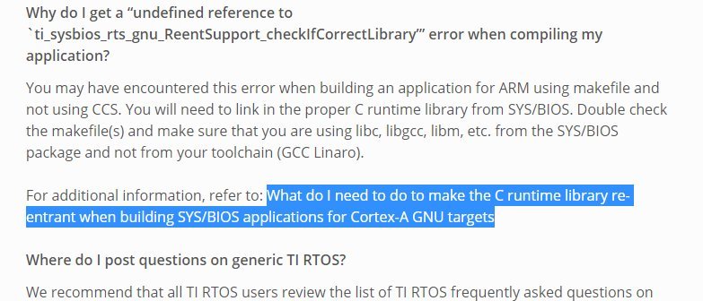

Now then...  This page:  e2e.ti.com/.../rtos-sysbios-gnu-linker-error-with-sysbios-v06-52-00-12
simply says to go to this page: software-dl.ti.com/.../FAQ.html
Which is useless, because it says " and not using CCS."   Well, I am using CCS.  It also says " make sure that you are using libc, libgcc, libm, etc. "  Well, what is "etc" ??  And is CCS failing to include whatever those "etc" libraries are?

    I managed to find one:   When I include stdc++ lib, I get the first unresolved:
    C:/ti/bios_6_46_05_55/packages/ti/sysbios/rts/gnu/ReentSupport.c:83: undefined reference to `ti_sysbios_rts_gnu_ReentSupport_checkIfCorrectLibrary'
    (Which, for some unpredictable reason, I was able to this diagnostic output insert as code...)
    So, now that I've troubleshot this more...  what is in the stdc++ lib that demands the presence of  the function ti_sysbios_rts_gnu_ReentSupport_checkIfCorrectLibrary?
    Where do I get it?
    Why isn't this documented anywhere (except a web page that blames users for not using CCS... when they are)?
    Please do NOT tell me to not use stdc++.  The use of std::string is used all over this project.  It is used with the TI compiler 17.3.0 STS...  Removing it is NOT an option.)

  • Jianzhong,
    Apparently, GNUC 7.3 is not supported in SYSBIOS 6_46_05_55/XDC 3_32_02_25
    It is necessary to use SYSBIOS 6_76_01_01/XDC 3_55_02_22
    This means the major project now must be updated to those packages concurrently.
