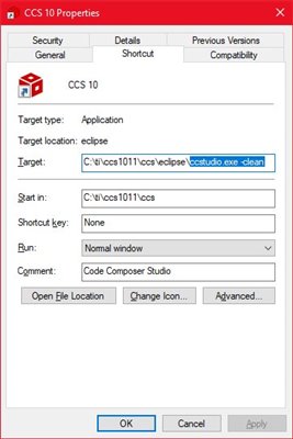

Still intermittent crashing on CCS 10.1
And my shortcut starts CCS clean EVERY time.
I have no idea WHAT is it failing at.  Or what it is corrupting in my workspace.  But since it's all not documented, and horrible looking XML, I fear what it might do and me not be able to repair it.
