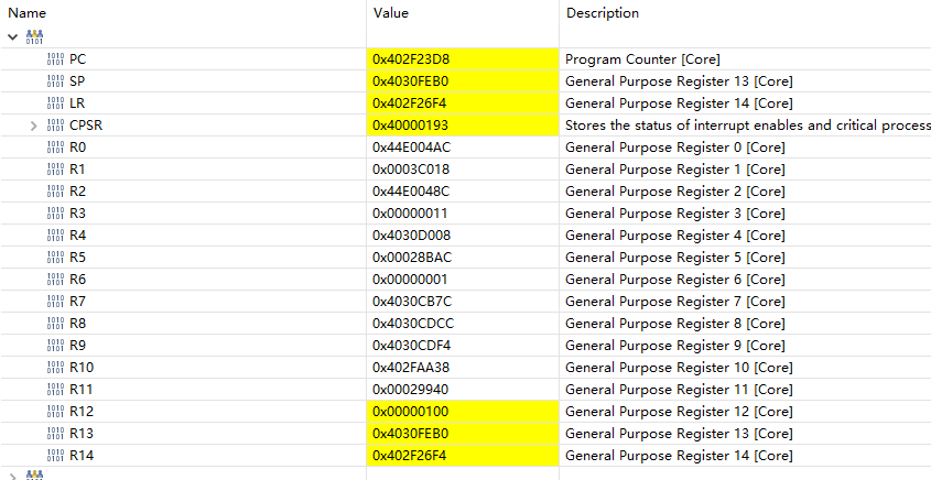

       I am set AM3355 boot from nand_flash,and i have so many AM3352,  but five out of a thousand machines fail,Boot failure can also occur when a machine in normal use is repowered,when problem is hapeen,It won't go back to normal。when problem happened,i read data from nand_flash and compare data from the normal startup machine,it is exactly same。and i see sysboot data ,it is correct
       i try to read out nand_flash block0 data  and then write it into block0 again,i found boot successful。so i can not understand why this problem happend? and  Are there any register that can display information or status during ROM_code start up, e.gcurrent boot  mode or device,whether the startup was successful?
