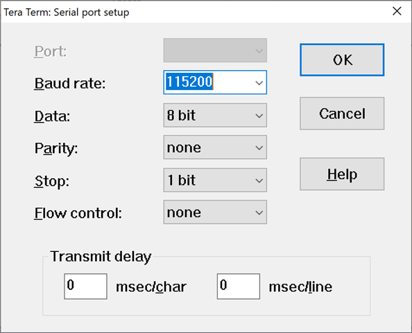

             After 'Header Transfer Complete!' flash programmer not send 'C'. serial console not print C. where i have change Baudrate?. please check and  Kindly help us for debug.
    Sathish

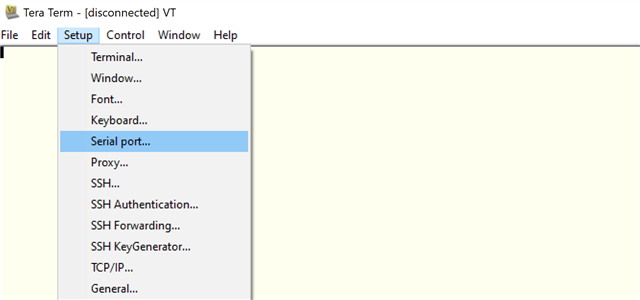

    you can change that from serial console settings.
    for example, in teraterm you can change as follows:
  • Hi Anubav,
                      i changed baudrate 3000000 to 115200 in ProcessorSDKSerialFlash.exe Uniflash application file. but i am not able to flash.

  • i changed baudrate 3000000 to 115200 in ProcessorSDKSerialFlash.exe
    As shown, i asked you change serial console (teraterm), not the .exe file.
