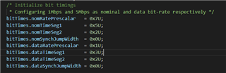

I'm using PSDK 07.02.00.06 and I'm using MCAN in MCU2_0. I'm using configuration from demo mcan_evm_loopback_app_main_k3.c, which bitrate is 1M and dbitrate is 5M. It works well.
Now I want to change bitrate to 500k and data bitrate to 2M, what should I change about bitTime configuration?
