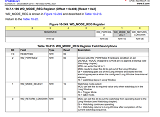

so I think if i want to set WD_MODE_REG Register in PAGE4.(offset is 0x406)
slave addr is 0x4c(0x48+4),reg addr is 0x6. Right?
root@j7-evm:~# i2cget -y -f 2 0x4c 0x6
0x20
But this register reset value is 0x2.why?
