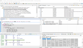

AM3352: Local variables can't be watched during CCS u-boot debug .
Part Number: AM3352
I checked this page training.ti.com/linux-board-porting-series-module-7-debugging-u-boot-jtag-ccs .
Then I understood how to debug u-boot by CCS.

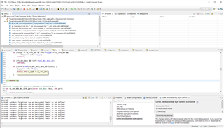

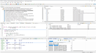

I succeeded in stopping at hardware breakpoint.
But I met a problem that local variable can't be watched.
As shown in Fig.1, I tried to click "fs_type" to watch this value, but value was not displayed and "Variables" window in the upper right corner displayed nothing in spite of "fs_type" was the first argument of fs_set_blk_dev() .
Could you please teach me how to watch local variables ?
As a supplementary explanation, optimization of fs.c was removed to debug this file as shown in Fig.2 .
On the other hand, I confirmed to watch local variables when SPL debugging (not u-boot) .
Fig.1
Fig.2
  • Could you please teach me how to watch local variables ?

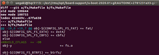

    You can try to use global variables just for debugging purpose.
    Even with "-O0", you may still not be able to watch local variables, because some passes during compilation that collect debug information are disabled with "-O0". You can try "-Og" instead. Please refer to the gnu compiler documentation.
    Jianzhong

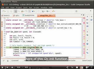

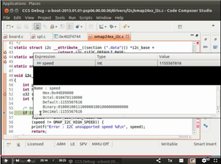

    I checked this video again.
    In this video, the first argument "int speed" of i2c_init() function defined in omap24xx_i2c.c was displayed when hover overring around "speed" as shown in Fig.1 and Fig.2 .
    But I can't find i2c_init() function in omap24xx_i2c.c.
    So, I can't try the same way which was demonstrated in this video.

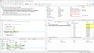

    By the way, I tried to hover over arguments of fs_set_blk_dev() function defined in fs/fs.c . Though this function has three arguments, any arguments was not displayed. Additionally, I tried a lot of functions, but the same problem occurred.
    Could you please teach me why this video succeeded in displaying local variable "speed" ? Is there something additional step to display ?
    Fig.1
    Fig.2
    Please make sure the compiler option for that specific source code is changed. Please also check the GNU compiler documentation regarding  keeping debug symbols: gcc.gnu.org/.../Optimize-Options.html.
    Also to clarify, what do you need or intend to do by debugging the U-Boot? Did you run into problems with U-Boot? There may be other ways to help you than debugging the U-Boot in CCS.
    Thanks and regards,
    Jianzhong

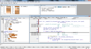

    I'm attaching two files when running "i2c dev 0" cmd @u-boot prompt for your reference:
    - am3_i2c_dev_0_bkpt.jpg: the screen-shot when hitting the the bkpt @ the entry of __omap24_i2c_setspeed().
    - am3_i2c_dev_0_call_flow.txt: the call flow when hitting the above bkpt.
    FYI: I'm using Lauterbach T32 JTAG debugger on AM335x GP EVM.
    -Hong

  • Thank you for reply.
    Why do you use Lauterbach ?
    I'd like to use CCS as shown in this video ( https://training.ti.com/linux-board-porting-series-module-7-debugging-u-boot-jtag-ccs ) .
    I have only possession of Lauterbach T32 JTAG debugger, but not CCS one.
    But the two attached files in my last post "should" apply to any JTAG debugger.
    For example, augments *i2c_base, ip_rev, speed, *waitdely are passed into __omap24_i2c_setspeed() via ARM registers R1, R2, R3, R4 as shown in the attached scrren-shot file.
    Have you tried the same bkpt using CCS on your set-up? If yes, can we capture a similar screen-shot?
    -000|__omap24_i2c_setspeed(
        |    i2c_base = 0x44E0B000,
        |    ip_rev = 1 = 0x1,
        |    speed = 400000 = 0x00061A80,
        |    waitdelay = 0x9DF54A38)
    -Hong

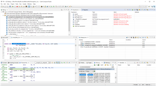

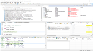

    I'm not familiar with either u-boot debugging or Lauterbach or CCS, so I don't know what bkpt means. Could you please teach me that ?
    By the way, I set a hardware breakpoint at __omap24_i2c_setspeed(), but program didn't stopped.
    So, I set a hardware breakpoint at fs_set_blk_dev(). After stopped, I captured CCS window as shown in Fig.1.
    Can you find any mistakes or wrong settings ?
    Fig.1
    Are you trying to JTAG debug SPL or u-boot?
    The example in my reply is from debugging u-boot, where relocating u-boot symbol might be needed.
    I'm attaching two PDFs:
    - SPL boot flow,
    - u-boot boot flow, where you'll find some info on u-boot relocation.
    JTAG debugging with CCS links:
    software-dl.ti.com/.../Apps-SPL-Debug.html
    software-dl.ti.com/.../Apps-Load-in-CCS.html
    -Hong

    Program stopped at hardware breakpoint as you mentioned above.
    But, any arguments (i2c_base, ip_rev, speed, or waitdelay) were not be displayed when I hovered over these variables as shown in the figure below.
    By the way, I'd like to tell you that it seems not possible that CCS attach the target CPU. I can't find "attach" button in CCS window.
    So I tried "Connect Target" button. This button seems to operate HW board reset automatically.
    Your attached screen-shot @bkpt @entry of __omap24_i2c_setspeed() looks good to me.
    The arguments *i2c_base, ip_rev, speed, *waitdely are passed into __omap24_i2c_setspeed() via ARM registers R0, R1, R2, R3
    They're matching the screen-shot and the call flow in my first reply.
    -Hong
    I understood that the arguments (*i2c_base, ip_rev, speed, *waitdely) were stored in R0-R3 registers respectively.
    Can you investigate why CCS didn't display these arguments' values when hovering over them ?
    I'm able to see "*i2c_base, ip_rev, speed, *waitdely" in T32 "watch window" as shown.
    I'd think the same would be possible in CCS.
    I'll check with my colleague on CCS.
    -Hong

    If you add the variable names (like speed) to the "Expressions" view what does it say there?  Does it show a value or say "Identifier not found"?
    John
    I tried that.
    It showed "Identifier not found" as the figure below.
  • If you step a few instructions into the function, does that cause the "Identifier not found" diagnostics to go away?
    Thanks and regards,
    -George
    I stepped some instructions to 0x8ff89fd0.
    Then, the value of local variable "fclk" was displayed as the figure below.
    But, the values of other variables were not displayed. It remained "Identifier not found".

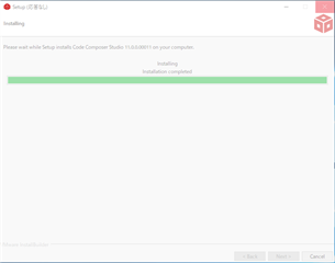

    By the way, CCS v11.0 installation process was frozen as the figure below. I think that it was no problem because "Installation completed" message was displayed.
