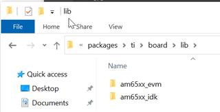

I want to run the PCIe example project on my two TMDX654IDKEVM boards.
When trying to follow this: http://software-dl.ti.com/processor-sdk-rtos/esd/docs/latest/rtos/index_overview.html#pdk-example-and-test-project-creation, MyExampleProjects is not generated.
Here is the command prompt printout when I run "pdksetupenv.bat" and then "pdkProjectCreate.bat am65xx am65xx_idk little pcie all arm":

Event through "am65xx_idk" looks like the correct board name, I have also tried "pdkProjectCreate.bat am65xx all little pcie all arm" nonetheless, but without success.
