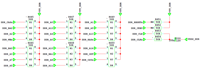

We have a problem on the DDR side with the AM4378 on some of our custom boards. Some boards work fine, but some do not boot, the SPL does not even appear. When we play with the parallel termination resistors of DDR_CLK and DDR_CLKN, some cards start booting, but the resistance values we change don't make sense, for example, it works when we insert 150 ohms instead of 56 ohms.
I am sending the EMIF spreadsheet we used in the attachment. I'm also posting the DSS output. Is there a point you see wrong?
Copy of Copy of SPRAC70A_AM437x_EMIF_Configuration_Tool_V21_ZC_070720.xlsx

DDR DATAHEET:
DDR3_128M16_NT5CB128M16JR-FL_2133.pdf
  • Please double check your software configuration, some values do not match with the spreadsheet.  For example, DDR_PHY_CTRL_1 = 0x8009 in the DSS script output above, but is 0x48009 in the spreadsheet.  Similarly, EXT_PHY_CTRL_1 is different.  Please check all values produced by the spreadsheet and ensure these values are in your software configuration.
