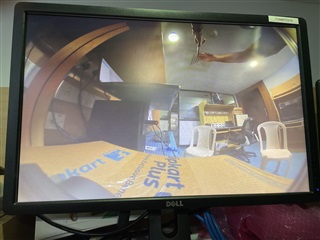

I am running single camera application after adding a new sensor driver (ISX016). I have done the following changes in the QNX+RTOS setup (07_03_00).
Serialiser : DS90UB913
Deserialiser : DS90UB964
1. Added a sensor driver folder (isx016) by referring "imx390".
2. Added Serialiser and deserialiser configurations in "isx016_serdes_config.h".
After adding the changes as mentioned in sensor_bringup_notes ,the newly added sensor is listed while running the application. But I was not able to get the image in the display. Seems like the "vxGraphParameterDequeueDoneRef" function waits for getting the data. Where I can look on to resolve this issue?

    The issue is resolved and we got the output image.
    Following changes were done to get this output.
    1. For getting the valid and stable PCLK from sensor, 12V input should be supplied to the camera using DES. This is achieved by open J14 and J16 pins and short J35 pins in Deserialiser EVM (DS90UB964).
    After this change the PCLK become stable and same is reflected in Serialiser register (0X0C). Value become 0x15 which means valid PCLK is detected.
    2. In the sensor driver side, the deserialiser register 0x7C is given the value 0xC1.
    3. Data format changed to "FVID2_DF_YUV422I_YUYV" in tivxCaptureExtractDataFormat function at PSDK_RTOS/tiovx/kernels_j7/hwa/capture/vx_capture_target.c
    Thanks for your support.
