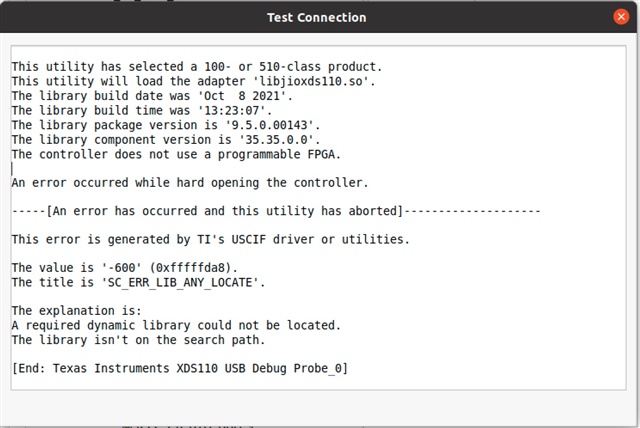

Using an SK-AM64 with CCS (latest, 11.0) on Linux distro. Having trouble with Target Configuration, Test Configuration yields:
The CCS distribution seems to be missing the lib, "libjioxds110.so." Installed Full CCS distribution, including all JTAG interfaces. I've reinstalled with no difference. Is this lib available?
I've looked on my inux distro, but could not find this lib. Also, no locating it with Linux Package Manager
    I tried this on Linux and had the same error. I also tried on Windows 10 and it worked fine without any problem. Let me loop in CCS expert to help.

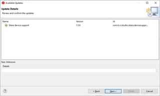

    Meanwhile, you'll need to update Sitara device support package to 1.5.6. Please go to CCS > Help > Check for Updates. It will show Sitara device support 1.5.6 as below:
    Follow the prompt to install the update. This will not fix the missing library problem, but just to give you a heads up.

    There was a known issue with CCS 10.3.0 where this error would occur with the Test Connection feature. But it would only impact the Test Connection feature. You should still be able to start a debug session and connect to the target. This issue was resolved in 10.4.0 but seems like the issue has returned.
    Can you confirm that you are able to start a debug session and connect to the target fine?

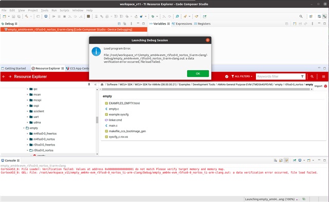

    Tried starting a Debug Session and got this result:
    “… a data verification error occurred, file load failed."
    This is an unrelated error. Since you are trying to load a program, I assume you were able to connect to the target. Hence this would confirm my suspicion above.
    As for the data verification error, there are many potential causes for this. Please see:

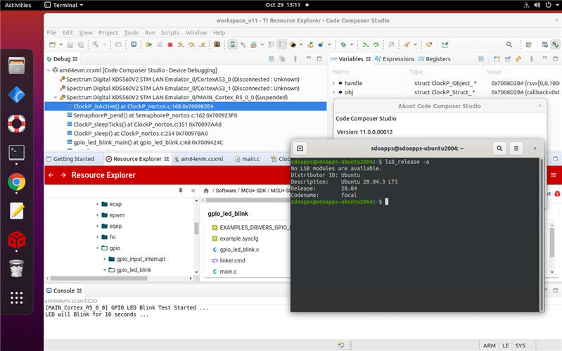

    I am able to successfully load and run the SDK examples on my AM64x EVM using CCS 11.0.0 on Ubuntu 20.04 LTS. In the screenshot below, I am using the gpio_led_blink example:
    https://dev.ti.com/tirex/explore/node?node=ABS8j0bysHPcpaTvmWPuhg__rN4Qml4__LATEST

  • Please provide a screenshot of the whole CCS IDE when the data verification error occurs.
  • Here are some screenshots:
    First error dialog for "gpio_led_blink"
    Second error dialog for "gpio_led_blink":
    Error running unmodified "empty" code:
    Hop you can see these screen shots with the uploaded resolution.
    For these screen shots, tried loading both codes. Modified nothing. Didn't config Sysconfig. Just tried to download code to see if I could get that far.

    Found that lib (libjioxds110.so) in my installation (/opt.ti/ccs/ccs_base/common/uscif/libjioxds110.so). Don't know yet why CCS is not finding it. XDS110 is specified in Target Configuration.
  • Found that lib (libjioxds110.so) in my installation (/opt.ti/ccs/ccs_base/common/uscif/libjioxds110.so). Don't know yet why CCS is not finding it. XDS110 is specified in Target Configuration.
    As mentioned before, please disregard this error. It is unrelated to the data verification error. It only impacts the Test Connection feature.
    Please see my video below. I am using CCS v11 connected to  an AM64 GPEVM via onboard XDS110 on Ubuntu 18.04LTS. I get the same library error when I run the Test Connection feature. However it has no impact on my debug session. I can start a debug session, connect to the target cores, load a program, and run/debug without issue:
    At the 0:40 mark, you can see that I get the same library error when running Test Connection. However I just proceed to debug the project without issue.

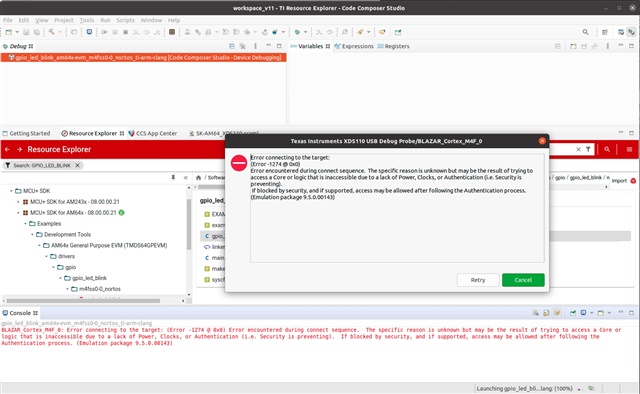

  • Ki, sorry for taking so long to reply.
    I finally got some time to work on this and I wanted to gather more data before responding..
    Got a small amount of good news and then some bad.
    The good: I followed your video (thank you very much). However, I didn't see anything different from what I had been doing. I followed each step. It worked!
    The bad news; It only worked one time. I know this is difficult to believe. A few hours later with everything still powered up, I clicked on the "debug" button and I got "Error -1170" issues. could not clear this problem and thoroughly didn't understand.

  • The good: I followed your video (thank you very much). However, I didn't see anything different from what I had been doing. I followed each step. It worked!
    First off, I think we can confirm that the "library" issue only impact "Test Connection". I filed a bug for this. Tracking link: https://sir.ext.ti.com/jira/browse/EXT_EP-10609
    This issue will not impact debug so we can set this aside for now.
    The DAP issue is is a fairly common one with many root causes. Please see the document below:
    https://software-dl.ti.com/ccs/esd/documents/ccs_debugging_jtag_connectivity_issues.html#cannot-access-the-dap
    What I find helpful on the AM boards is to do a System Reset before trying to connect. It helps put the board in a good state
