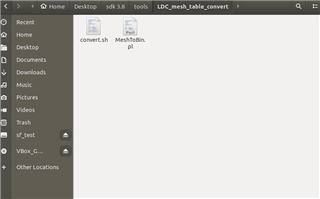

  • Hello Lucas!
    I have downloaded the SDK you mentioned but unfortunately  "LDC_mesh_table_convert" only have " MeshToBin.pl "  converter file. I need to convert my mesh to Header file not bin file. Another problem is that, I searched for documents about how to create it but could not find any. Please help regarding this matter.
    Kind Regards,
    Myrah Naeem
  • Hi Myrah,
    I just downloaded SDK3.7 from the link above and checked "convert.sh".
        perl MeshToBin.pl $1 $2 $3 $4
        xxd -c2 -i $1.bin
    The 2nd line prints out a C data array to console with 0-padding for 16-byte row alignment for each row of data in the LUT.
    unsigned char lut_front_m4_txt_bin[] = {
    0x6c, 0x0d,
    0x2b, 0x0c,
    0x61, 0x0d,
    0xd5, 0x0b,
    0x55, 0x0d,
    0x80, 0x0b,
    The printing looks correct to me.
    Is that what you are looking for?
    Gang
  • BTW, this is what I did:
        ./convert.sh lut_front_m4.txt 1280 1280 16
    TDA4 LDC LUT frame size is 1280x1280 and LUT downsampling rate is 16x16 (m=4).

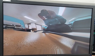

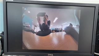

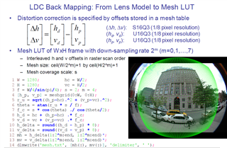

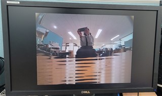

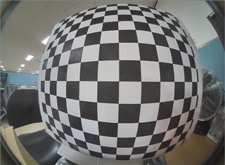

  • Hello Gang ,
    Thank you very much for your reply.
    I am little confused about the whole procedure can you please guide me if I am going in the right direction.
    I tried to use sample mesh LUT from sample but I did not get the good results because my camera (ISX016) is capturing images of 1280x944
    So I searched for TI support forms to create mesh LUT myself according to this procedure
    https://e2e.ti.com/support/processors-group/processors/f/processors-forum/1042074/faq-tda2pxevm-how-to-create-a-mesh-lut-for-tda2p-tda3-ldc?tisearch=e2e-sitesearch&keymatch=MESH%2520LUT#
     I first tried to create mesh without  (spec file and focal length) so I used MATLAB code from the document you mentioned on support forms

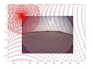

    I kept all parameters same except for Image Height H= 944 but when I plot the mesh on image (taken from same camera), the results are different.
    Then I tried to create mesh.txt ( from lens specification) using your document code but still when I plot the results are weird like this.
    my parameters for lens specification mesh LUT generation are
    gen_lut(spec_file, pitch_in_mm,f_in_mm, W, H, hc, vc,s ,m)
    gen_lut("spec_file.txt", 0.0056,0.85, 1280, 944, 640, 472, 2, 4)
    pixel pitch = 0.0056
    focal length = 0.85 mm
    W =1280
    H = 944
    s =2
    m= 4
    I am attaching spec file and matlab code, Image I am using. please let me know what mistakes am I making ?
    function [] = gen_lut(spec_file, pitch_in_mm,f_in_mm, W, H, hc, vc,s ,m)
    f = f_in_mm/pitch_in_mm ;
    [h_p , v_p] = meshgrid( 0:W, 0:H);
    [h_d,v_d] = xyz2distorted(h_p,v_p, f/s, hc, vc,spec_file, pitch_in_mm);
    h_delta = round((h_d-h_p) * 8);
    v_delta = round((v_d-v_p) * 8);
    mh = h_delta(1:2^m:end, 1:2^m:end);
    mv = v_delta(1:2^m:end, 1:2^m:end);
    matrix = [mh(:), mv(:)];
    %dlmwrite('mesh.txt', [mh(:), mv(:)],  'delimeter', '');
    writematrix(matrix,'mesh1.txt');
    disp(matrix);
    I = imshow('frames1.bmp');
    axis on;
    hold on;
    % Plot cross at row 100, column 50
    plot(mh, mv, 'r+', 'MarkerSize', 20, 'LineWidth', 1);
    end

    Everything looks correct except the line for plotting the crosses.
    I suppose you would like to plot the "(h_d, v_d)" rather than the H/W encoded values of "(hv, mv)".
    If you change it to the line below, you shall be able to get correct pixel locations.
    plot(h_d(1:2^m:end, 1:2^m:end), v_d(1:2^m:end, 1:2^m:end), '.');
    Gang

    but the results are like this
    I tried to change  LDC_DS_FACTOR = 2 and LDC_BLOCK_HEIGHT = 64 But results are same.
    Please guide me How can I resolve this issue?

  • Hi Myrah,
    Yes, 2.8um seems reasonable.
    The output block size of 64x32 is too large and LDC runs out of internal memory while loading input image blocks.
    You just need to reduce the output block size until no artifacts is visible.
    Block width must be 8x and block height must be 2x.
    Gang

    I have attached a .zip file containing grid pattern YUV422 8bit packed image.
    YUV Image.zip
    Some how the image with customized mesh LUT looks like this.
    Image with LDC ENABLED
    Image without LDC ENABLED

  • Hi Myrah,
    From you output images above, it looks like that you have some LDC programming issue.
    I see some typos in your shared code above which will lead to wrong output LUT.
    Using information and image you provided, I created the steps below for explaining the work flow for TDA4 PSDK.

    1. Below is the corrected matlab/octave code:
    mh = h_delta(1:2^m:end, 1:2^m:end)';
    mv = v_delta(1:2^m:end, 1:2^m:end)';
    dlmwrite('mesh.txt', [mh(:), mv(:)],  'delimiter', ' ');
    function [h_d, v_d] = xyz2distorted(x, y, z, hc, vc, spec_file, pitch_in_mm)
    [phi, r] = cart2pol(x-hc, y-vc);
    theta = atan2(r, z);
    lut = read_spec(spec_file, pitch_in_mm);
    r = interp1(lut(:,1), lut(:,2), theta);
    [h_d, v_d] = pol2cart(phi, r);
    h_d = h_d + hc;
    v_d = v_d + vc;
    function lut = read_spec(spec_file, pitch_in_mm)
    lut0 = dlmread(spec_file);
    theta = lut0(:,1)/180*pi;
    lut = [theta, lut0(:,2)/pitch_in_mm];
    2. You may call the above matlab code as below:
        s = 2;
        m = 4;
        pitch_in_mm = 0.0028;
        f_in_mm = 0.85;
        W = 1280;
        H = 944;
        hc = W/2;
        vc = H/2;
        Wmesh = ceil(W / 2^m) * 2^m;
        Hmesh = ceil(H / 2^m) * 2^m;
        gen_lut("spec_file.txt", pitch_in_mm, f_in_mm, Wmesh, Hmesh, hc, vc, s, m);
