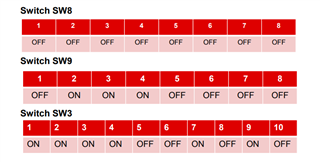

  • Hi Viswa,
    The boot switch setting are incorrect. Please refer the appnote https://www.ti.com/lit/an/spracy5/spracy5.pdf table 3.1 for the switch setting.
    You need to apply the patches as mentioned in https://e2e.ti.com/support/processors-group/processors/f/processors-forum/1041155/faq-tda4vm-j721e-j7200-enabling-dfu-boot-on-8-0-linux-sdk then rebuild u-boot and use this to send over usb.
    Karan
  • Hi Karan,
      I changed the switch as specified in the switch as specified in the document. im able to find

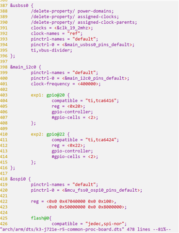

  • Hi Keerthy,
      It is not working. Patch file is not being applied since the lines are different in the source code and the patch file.
    We are using the ~/ti-processor-sdk-linux-j7-evm-08_00_00_08 version.
    uic68347@igl5718u:~/ti-processor-sdk-linux-j7-evm-08_00_00_08/board-support$ cd u-boot-2021.01+gitAUTOINC+53e79d0e89-g53e79d0e89/
    uic68347@igl5718u:~/ti-processor-sdk-linux-j7-evm-08_00_00_08/board-support/u-boot-2021.01+gitAUTOINC+53e79d0e89-g53e79d0e89$ git log -1
    commit 0a85f506a3b65e730f746380b840f0ebe8908727 (HEAD -> ti-u-boot-2021.01)
    Author: Aswath Govindraju <a-govindraju@ti.com>
    Date: Thu Aug 26 21:28:58 2021 +0530
    environment: ti: k3_dfu: Increase the size allocated for bootloader images in dfu_alt_info_ram
    The size of u-boot.img is above 1MB and that of tispl.bin is close to 1MB,
    in case of j721e. Therefore, increase the sizes allocated for tispl.bin and
    u-boot.img to 2 MB and 4 MB respectively, in dfu_alt_info_ram environment
    variable.
    Signed-off-by: Aswath Govindraju <a-govindraju@ti.com>
    uic68347@igl5718u:~/ti-processor-sdk-linux-j7-evm-08_00_00_08/board-support/u-boot-2021.01+gitAUTOINC+53e79d0e89-g53e79d0e89$ git branch
    master
    * ti-u-boot-2021.01
    uic68347@igl5718u:~/ti-processor-sdk-linux-j7-evm-08_00_00_08/board-support/u-boot-2021.01+gitAUTOINC+53e79d0e89-g53e79d0e89$ tar xvf dfu-fixes-8.0.tar
    uic68347@igl5718u:~/ti-processor-sdk-linux-j7-evm-08_00_00_08/board-support/u-boot-2021.01+gitAUTOINC+53e79d0e89-g53e79d0e89$ git am dfu-fixes/1-3-arm-dts-k3-j721e-r5--.dts-Fix-clock-names-property-in-the-usb0-instance.patch
    Applying: arm: dts: k3-j721e-r5-*.dts: Fix clock-names property in the usb0 instance
    error: patch failed: arch/arm/dts/k3-j721e-r5-common-proc-board.dts:280
    error: arch/arm/dts/k3-j721e-r5-common-proc-board.dts: patch does not apply
    Patch failed at 0001 arm: dts: k3-j721e-r5-*.dts: Fix clock-names property in the usb0 instance
    Use 'git am --show-current-patch' to see the failed patch
    When you have resolved this problem, run "git am --continue".
    If you prefer to skip this patch, run "git am --skip" instead.
    To restore the original branch and stop patching, run "git am --abort".
    Viswa

  • Yes Karan,
       Im in the wrong version of the commit id. I moved to exact commit id specified and able to apply the patches. Thank you.
