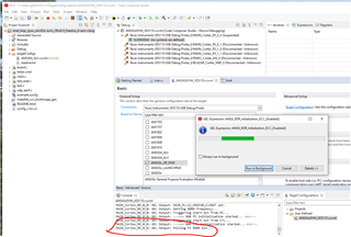

  • Hi Prasad,
    Tried the gel scripts but this did not solve the issue.  In fact, this only reproduced the same problem that prompted me to start the thread with Ming about a month ago.  Here is a link to that thread for your review:
    TMDS243GPEVM: DDR initialization hangs - Processors forum - Processors - TI E2E support forums
    Please note that this time I Reinstalled CCS with the latest version (CCS 11.1) and also reinstalled mcu_plus_sdk_am243x_08_01_00_36.
    After installing CCS and SDK I generated a new target configuration file (Targeting  AM243x_GP_EVM).
    Next, I imported and built enet_lwip_cpsw_am243x-evm_r5fss0-0_freertos_ti-arm-clang from the SDK.
    Started a debug session using the new target configuration file, Connect to R5_0_0, Run AM24 Initialization script.  The following is a screen shot of the result:
    This is the same problem that eventually prompted Ming to advise me to use the AM64-EVM boot code and example code. (see the above link).
    So, What next?
         Joel
