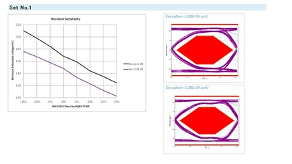

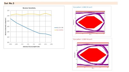

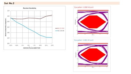

    • The customer's board (abbreviated as "set" below) uses both USB0 and USB1 of K2G as Device ports.
    • Some sets have a problem with USB0, some with USB1. In normal temperature and high temperature, the reproduction rate is 100%, and the problem occurs only in either USB1 or ISB0 depending on the set.
    • The number of generated sets is 10/85.
    • The problem occurs even if the destination PC is changed.
    • There is no clear difference in the eye pattern between OK and NG Sets, but there are cases where USB packets are not being received properly. (This is determined by confirming that a receiving error has occurred in the software.)
    • The eye pattern is normal and there is no problem with the characteristic impedance of the transmission line of the USB D+/D- board, but the symptom occurs when using a long cable (4m).
    • In order to investigate the cause of the problem, they performed the Reseiver Sensitibity Test using the test FW to adjust USB*_PHY_PC_SQRXTUNE, and checked if there was any change in the receive limit voltage and the squelch voltage.
    • For the port with USB0/USB1 problem, even if USB*_PHY_PC_SQRXTUNE is changed, the receiving limit voltage and the squelch voltage of Receiver Sensitibity Test are not changed.
    • As a result of modifying the circuit to the minimum configuration that causes the problem in the set, they have confirmed that the problem is not with the peripheral components (common mode filter and USB switching IC), but with the set in which the K2G is mounted.
    • The cross-check on the IC itself is in progress and the result will be announced soon.
    • They are using TPS65911AA2NMAR for the start-up sequence, and there is no problem.(Please let me know if there is any power supply that may be related to this case.)
    The following is the information about the normal set, the set with the problem in USB0, and the set with the problem in USB1.
    [Question 1]
    They have set "BOOTCFG_USB*_PHY_CTL0~4" at the time of reset release after power-on from PMIC, is there any procedure or timing for setting USB*_PHY_PC_SQRXTUNE?
    [Question 2]
    Although there seems to be no problem in Errata, is there any example of trouble that the register settings cannot be reflected when BOOTCFG_USB*_PHY_CTL0~4 are changed from the default values at startup?
    They have confirmed that although the values are changed by reading the registers immediately after the register change, the receive limit voltage value of ReceiverSensitibity changes in the Ok set, but does not change in the NG set.
    [Question 3]
    As shown in sets 2 and 3 of the table, some of the receive limit voltages are high even at the default setting values. In this case, the receive sensitivity voltage could not be lowered even with the register setting. Is there any possible reason for this?
    [Question 4]
    Please tell me, what voltage value and how does it vary with the value of USB*_PHY_PC_SQRXTUNE(default and other adjustments), and the adjustment table when changing.
    We understand that these registers are used with default values. Whether or not I actually change these registers, as a customer I need this information as a clue to solving this problem. I would appreciate your cooperation.
