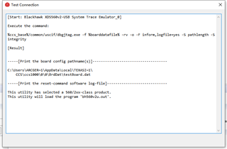

    SB45959-There is one unsuccessful boot counter inside the device so that you can plug and unplug more than 10 times for 3 to 5 seconds each time and be in safe mode. When you enter safe MODE, the MODE indicator will be red,The mode light is still blinking green.
    In the video, SB46011 and SB45959 operate. SB46011 can automatically enter the safe mode, but SB45959 cannot enter the safe mode no matter how hard we try.
    SB46012- The page as shown below is not successful.succeeded is not displayed.
  • In the video, SB46011 and SB45959 operate. SB46011 can automatically enter the safe mode, but SB45959 cannot enter the safe mode no matter how hard we try.
    SB46011 seems to boot up and enumerate successfully (when both LEDs turn GREEN). The other seems to never boot up successfully. After several (unsuccessful) boot up attempts, it should try to boot up in safe mode (blinking RED MODE LED). If this never happens, it could be a bad probe. Note that you may need to have several boot failure in a row before the probe tries to boot into safe mode. I assume the customer tried many times. Assuming that is the case, they may want to contact Blackhawk support for further assistance (this issue is beyond my scope of expertise).

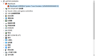

    This seems to be working. I don't see any issue here. The probe boots up successfully and both lights turn solid green. This is good.
    SB46012-Is it good or bad? Is it possible to return or exchange goods?
    I'm not sure. That probe seems to boot up ok but CCS is having issue communicating with the probe. I suggest the customer try rebooting the PC and plug in the probe in a different USB port directly to the PC (no hub) and try "Test Connection" again.

    About SB46012- We are all USB straight plug, not through hub splitter, we tried all the methods you mentioned. Also changed different computers to test, the results are the same。
  • About SB46012- We are all USB straight plug, not through hub splitter, we tried all the methods you mentioned. Also changed different computers to test, the results are the same。
    Please have the customer try testing using the BH560v2 configuration tool. The probe may be in safe mode and you can also use the tool to clear safe mode.
    The document for the BH560v2 config tool is the Bh560v2Config-UG-05.pdf document in the zip I attached earlier.
