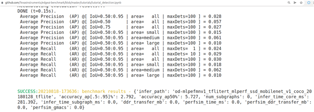

1. situation
I download ssd_mobilenet_v1_coco_2018_01_28 tflite model(link) from ti model zoo and try to compile it following the official guide notebook(link).
then , I can get though the whole process and come up with a packaged model with artifacts.
However, mAP generated by Ti edgeai benchmark even in your original official notebook(In 9) mentioned above is quite low:
Average Precision (AP) @[ IoU=0.50:0.95 | area= all | maxDets=100 ] = 0.028 (this is too low and should be about 0.23 )
Average Precision (AP) @[ IoU=0.50 | area= all | maxDets=100 ] = 0.057
Average Precision (AP) @[ IoU=0.75 | area= all | maxDets=100 ] = 0.027

3. question
I test the compiled model created by official notebook on tda4 sk and hardly detect any object and could get good detect result created by run_benchmarks_pc.sh
I guess there must be wrong settings in your guide notebook and please tell me how to compile ssd_mobilenet_v1 to get acceptable mAP, as I might use other models which are not from TI' s modelzoo and have to be compiled in this guide notebook.

Each model has different preprocessing requirements. The scripts in the notebooks does not implement that separately for each model - I think it uses Pillow resizer for all models, whereas this particular model should use OpenCV resizer for best results - because that is how it was trained. Can you try using the OpenCV resizer and see if the result improves?
Another option is to use edgeai-benchmark itself for custom models. Please see the example script here: https://github.com/TexasInstruments/edgeai-benchmark/blob/master/scripts/benchmark_custom.py
(Comment out the existing models and add yours, by looking at the examples in this script)
Note: This script is not tested often - if there is any issue in this script, please let us know and we shall help.

Thank you for your reply. I recheck the code and the backend is cv2. so I guess there might be other setting which result in this issue.
1.Rerun the updated official notebook
I notice that the official notebook with a high mAP result has been updated after my last post issued. however, when I rerun the updated official notebook, I get even worse mAP result than before. Map on coco eval dataset are all zero now.
